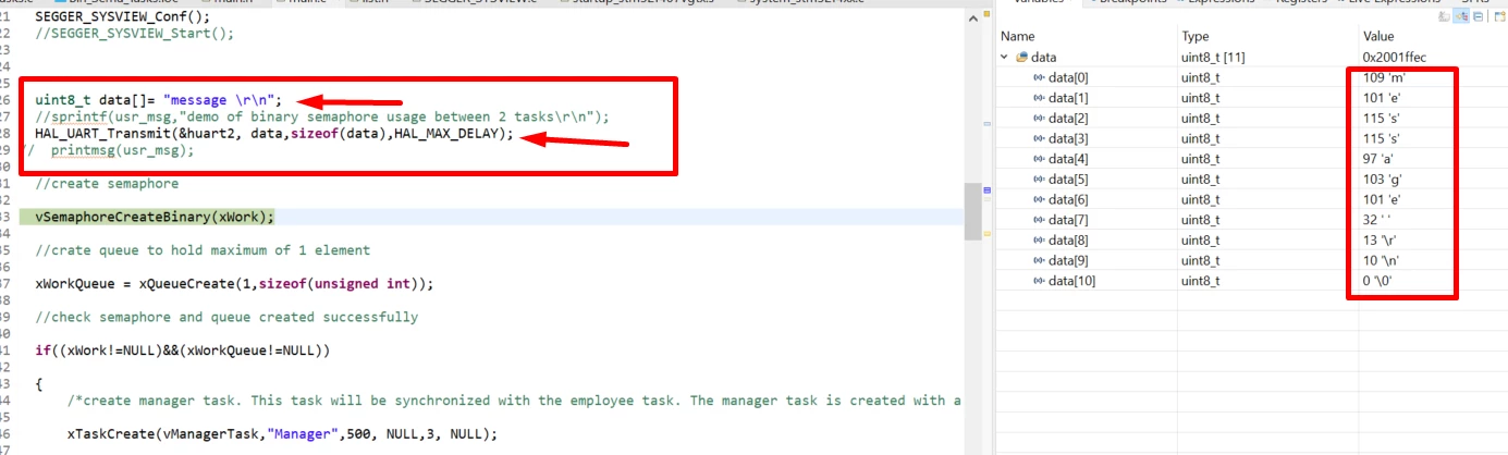

When I run the below code, I get the result on serial console as in below image which is not as expected. Could you please let me know what I am missing here ?

 uint8_t data[]= "message \r\n";
 //sprintf(usr_msg,"demo of binary semaphore usage between 2 tasks\r\n");
 HAL_UART_Transmit(&huart2, data,sizeof(data),HAL_MAX_DELAY);

    You have only one uart, but you initialize it twice:
     MX_USART2_UART_Init();
     /* USER CODE BEGIN 2 */
    SEGGER_UART_init(250000);
    Note that "MX_USART2_UART_Init()" has initialized the uart with baudrate 115200.
    Then "SEGGER_UART_init(250000)"  does this again but with baudrate 250000.
    Delete the call to SEGGER_UART_init. And try again.

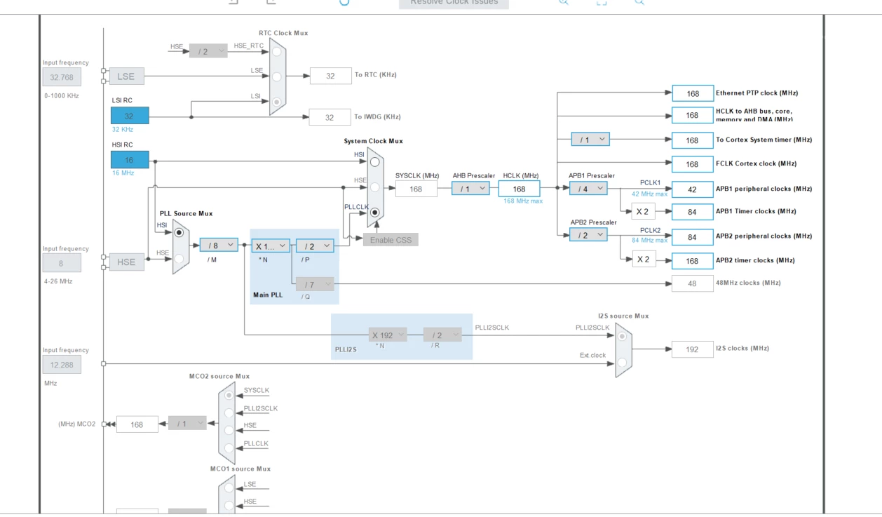

    Either you have the settings wrong for baud rate, or wrong HSE_VALUE
    For strings use strlen() or sizeof()-1 to not send the NUL over the wire

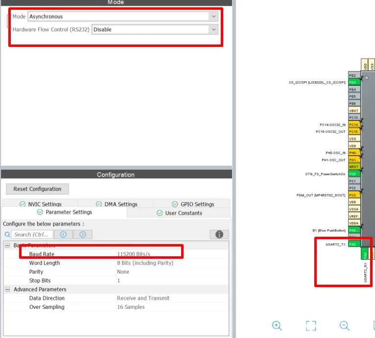

    I am using HSI as shown in below image.
    The baudrate should also be OK.
    I am using FreeRTOS in my application. May it be causing the issue ?

     huart2.Instance = USART2;
     huart2.Init.BaudRate = 115200;
