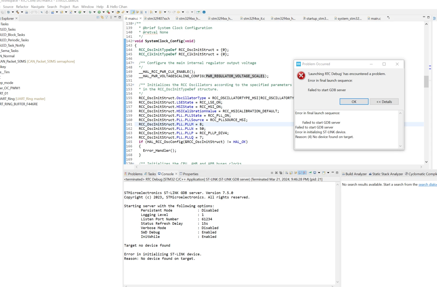

    AScha.3
    March 20, 2024
    which board ?
    custom/ which cpu ?
    What you connect to ---> usb ?
    Tesla DeLorean
    Guru
    March 20, 2024
    >>Does anyone have any idea about the root cause ?
    Are you sure the code is running?
    Can you toggle a GPIO/LED at the same time?
    Configuring the right pins, code not shown, connectivity not diagrammed. Hard to diagnose with the imagination.
    Can you look at the signals with a scope?
    demirAuthor
    Senior
    March 21, 2024
    I have added  HAL_GPIO_TogglePin(GPIOD, GPIO_PIN_14) to check if code is actually running, you are right that it doesnt run at all.

    Sorry guys.
    My board is STM32F407VG-DISC1.
    I am encountering an issue now that is I cant connect to the board. Please see the error I get below.
    demirAuthor
    Senior
    March 21, 2024
    I have updated the ST Link firmware and issue disappeared. I can test that UART is working, I have just written a simple code to check and I can see via serial console that UART is fine.
    On the other hand, the original issue still persists.
