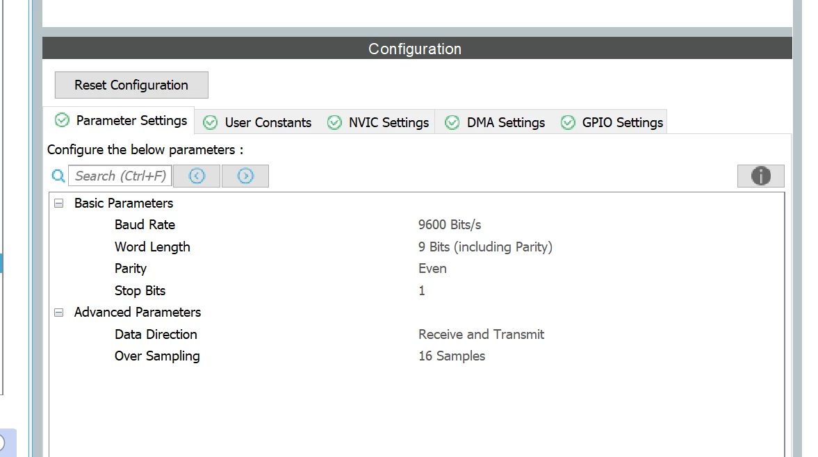

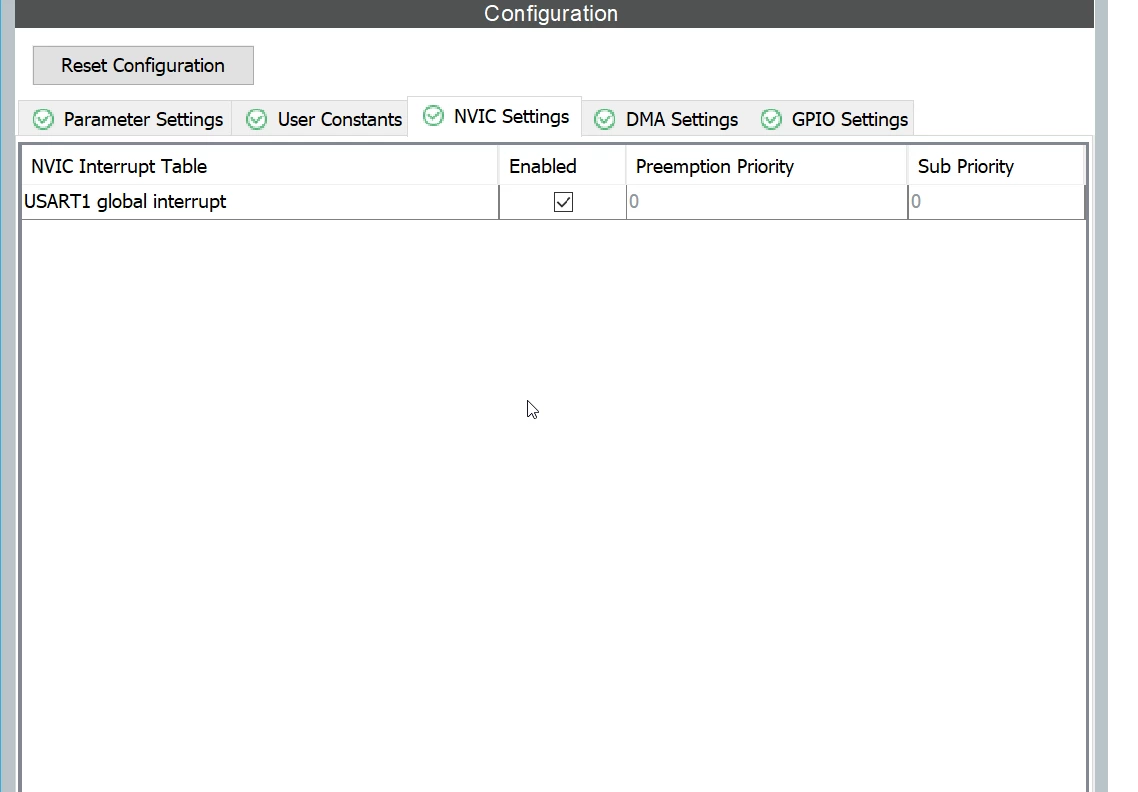

    You could start with an example without checking register modification to start from.
    If you connect RX and TX on your board the code attached should be all you need of modifications after CubeMX generated your serial application.
    The printf statements are there for diagnostics purposes, do not use them in production code.

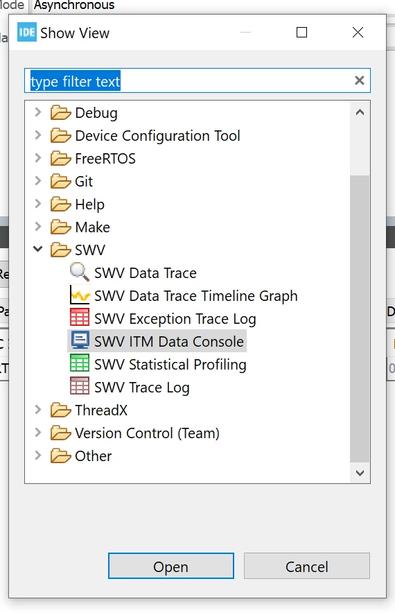

    If properly configured you can see output in the ITM data console.
    Properly configured would mean: debug settings (enable SWV) and in the ITM data console: (configure trace & enable trace)
    Best Regards,
    Johi.
