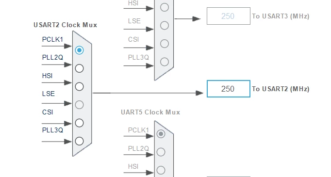

UART configuration directly with registers, NUCLEO-H563ZI board
I am using the NUCLEO-H563ZI board and I am trying to configure the UART2 using only registers.
I started by creating a fresh and simple new code with STM32CubeIDE for UART transmit because I wanted to use a simple uart_transmit function but I had trouble making it work until I activated the USB as Host_Only from the .ioc
Pinout & Configuration and only then was I able to use the HAL_UART_Transmit to send a text to a terminal and I would like to know why that is.
Then I want to be able to configure the UART2 directly with the registers but then the code breaks how can I make this work? Thank you.

gbm
April 11, 2024
There is no AFR[2] register. The bits you want to set are in AFR[0].
Don't do logic operations on USART CRx registers. Simply write the proper values to them. For basic setup. you only need to set BRR and CR1 - two assignments are enough.
My STM32 stuff on github - compact USB device stack and more: https://github.com/gbm-ii/gbmUSBdevice
G-PouliosAuthor
April 12, 2024
Thank you but it still doesn't work

also I see the clock config for the UART2 and it's 250MHz from the PCLK1, should I change that?
