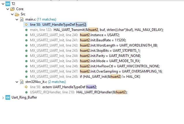

Uart Circular buffer , Error while building using Nucleo 429zi Just did what is in the video in the link https://controllerstech.com/ring-buffer-using-head-and-tail-in-stm32/ The error is as shown in the details
arm-none-eabi-gcc -o "Uart_Ring_Buffer.elf" @"objects.list"  -mcpu=cortex-m4 -T"C:\Users\User\STM32CubeIDE\workspace_1.8.0\Uart_Ring_Buffer\STM32F429ZITX_FLASH.ld" --specs=nosys.specs -Wl,-Map="Uart_Ring_Buffer.map" -Wl,--gc-sections -static --specs=nano.specs -mfpu=fpv4-sp-d16 -mfloat-abi=hard -mthumb -Wl,--start-group -lc -lm -Wl,--end-group
c:\st\stm32cubeide_1.8.0\stm32cubeide\plugins\com.st.stm32cube.ide.mcu.externaltools.gnu-tools-for-stm32.10.3-2021.10.win32_1.0.0.202111181127\tools\arm-none-eabi\bin\ld.exe: ./Core/Src/main.o:C:/Users/User/STM32CubeIDE/workspace_1.8.0/Uart_Ring_Buffer/Debug/../Core/Src/main.c:50: multiple definition of `huart2'; ./Core/Src/UartRingbuffer.o:C:/Users/User/STM32CubeIDE/workspace_1.8.0/Uart_Ring_Buffer/Debug/../Core/Src/UartRingbuffer.c:15: first defined here
collect2.exe: error: ld returned 1 exit status
make: *** [makefile:64: Uart_Ring_Buffer.elf] Error 1
"make -j8 all" terminated with exit code 2. Build might be incomplete.

Error says you defined a variable in two files. Need to not do that​.
Decide where you want it, and use extern elsewhere.​

RKore.1
RKore.1Author
March 30, 2022
After searching huart2 in my code as shown below , I use extern as you mention
Do you see any error (multiple definition of `huart2';) ?

Is it in an include file?
March 30, 2022
The error indicates that you've defined huart2 in UartRingbuffer.c on line 15. It shouldn't be defined there. Use extern. Would be easier to spot the error if you attached the relevant files.

Thanks , Tesla & TDK
you are correct it was in UartRingBuffer.c
