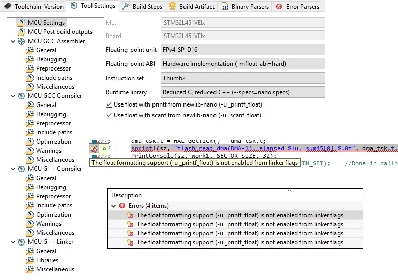

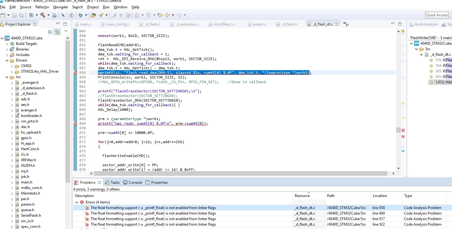

When I compile, I get the following error:
The float formatting support (-u_printf_float)is not enabled from linker flags
I can't find Linker flags/Options/Settings for C - just for MCU G++ Linker. When I chose the option, it still didn't remove the error. It compiles, though and can be run.

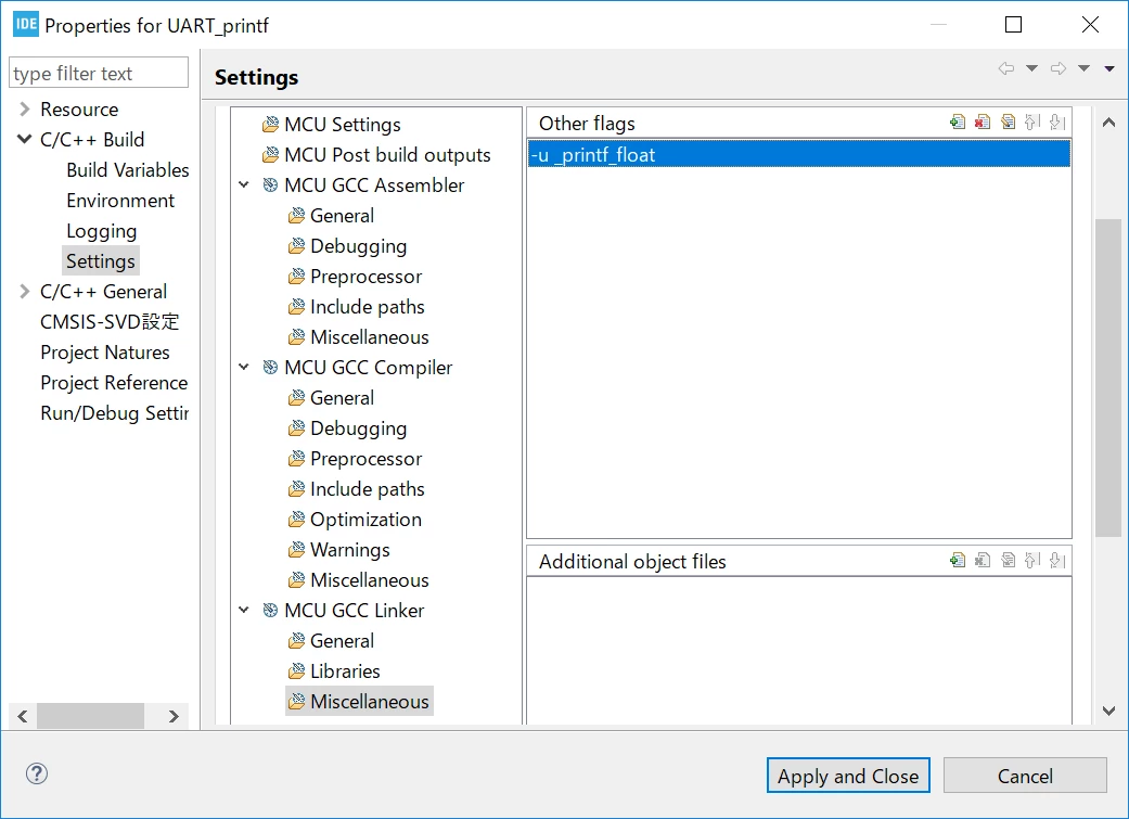

Best answer by Yuk117
This problem is fixed in STM32CubeIDE ver.1.0.2.
Workaround in older version is to add "-u _printf_float" to MCU GCC Linker -> Miscellaneous -> Other flags.

Where is LDFLAGS (linker flags) set?

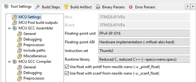

I've been asked to introduce this new IDE to the other FW developers on our team.
I still have this float-printf problem .
Even after I choose the settings, I get the error...

You are using "newlib-nano" standard C library and it doesn't support float printf anyway. So even if you fix your compilation / link option issue, it will not work (for example a printf of a float will return 0.0000).
if I remember correctly (not sure though), "newlib" should support float printf.

Thanks for noticing that...
I changed the library to the regular C/C++ standard, and I still get the error. (I Rebuilt the whole project)

" It compiles, though and can be run" So it is a build error or not ? It's not clear. And can you printf float variables at the end ?

As you've seen yourself - these errors are mentioned, but the project can be debugged.
I haven't been able to see the printfs in the SWV console - that's another thread that I opened in the forum...

Yuk117
Yuk117Best answer
July 19, 2019
