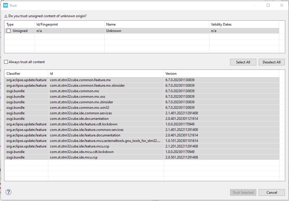

Hello everyone,
During the installation of CubeIDE 1.11.2, on Win10 (see screenshot), I received a warning about installing unsigned content. Same problem arises on Mac OSX.
What could be the cause and how to solve this issue?
Thanks for your help!
mattias norlander
This is nothing to worry about. We do not sign the plug-ins on our update site as of yet.
We only sign our full installers. This is why the update system is warning the user.
Select All > Trust Selected is the solution.
Kind regards, Mattias

Visitor II
Thank you for clarifying. I understand the current process, but I'm concerned about the security implications of not signing the updates. Could you consider signing all components in the future to ensure better security and user confidence? Or are there any reasons to not signing the update that I am not aware of?
