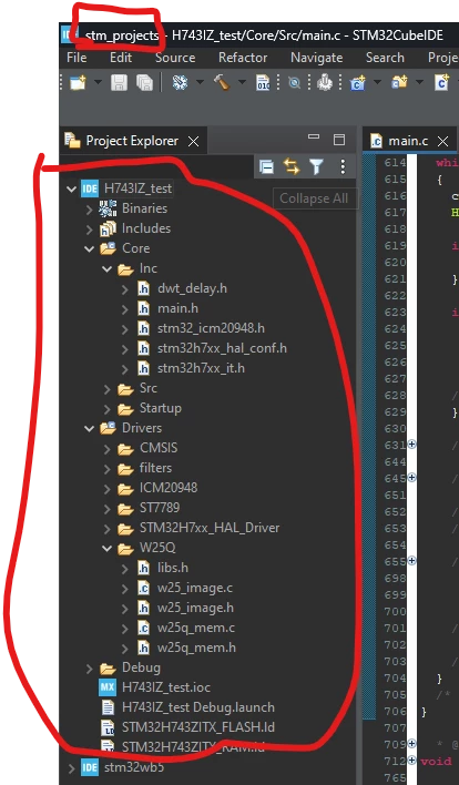

I attempted to link my STM32 project with GitHub, following the guide
How to use Github with STM32cubeIDE in 2023 - Shady Electronics
I managed to complete all the steps, but for some reason, I couldn't push my project to the repository.
Initially, I decided to continue without syncing it to GitHub. However, I soon noticed that my entire project has vanished from its folder on my computer.
When I open STM32CubeIDE, I can still access the project, as illustrated here:

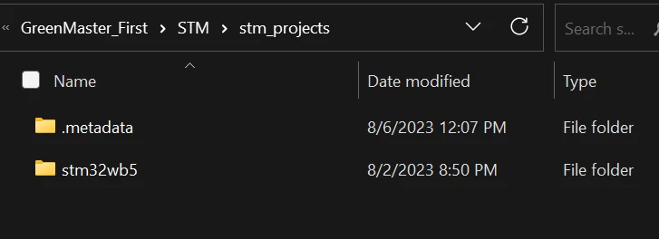

Yet, when I navigate to the 'stm_projects' directory on my PC (where STM32CubeIDE indicates it should be), the project is missing:
As evident, only the 'stm32wb5' project is present, which is also visible in the previous image.

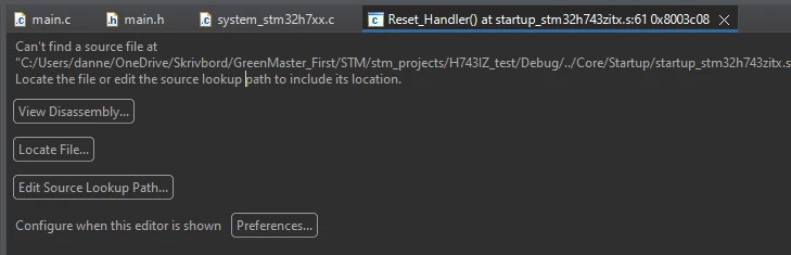

When I attempt to compile and debug, an error message from Reset_Handler() states "source file not found". Surprisingly, it still compiles and operates without issues.

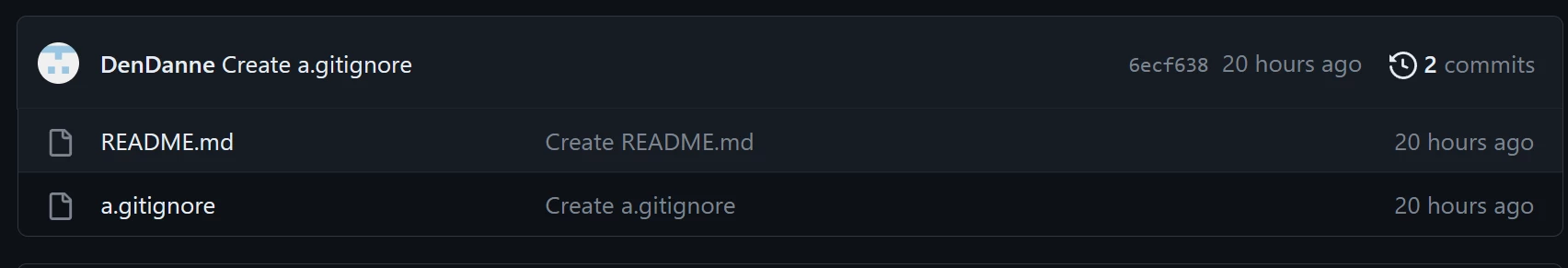

Moreover, the GitHub repository I intended to push to doesn't show any record of the project.
I even searched my PC for unique files from the project, like "w25_image.c" displayed in the first image. Sadly, I found no trace of it.
It's also missing from my GitHub. I'm growing increasingly concerned about potentially losing the entire project. Does anyone have insights or suggestions on this?

    Right click a file -> Properties, then go to the Resources tab and it will show you the location of a file on your computer. That should let you find out where it is.
    It's compiling, so it's there somewhere.

    Please go to the github web interface and try to find your project there. Do you see your commits and source files?
    If it is not there, and it is not on your PC, then... it isn't anywhere ((  A precious experience point unlocked.

    Thanks! The project had been moved to AppData -> Roaming -> SPB_Data -> git
