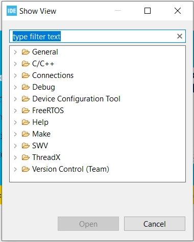

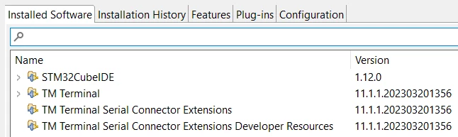

I'd like to add the TM Terminal plugin to STMCubeIDE 1.12.0.
I did add:
After installation and restart the plugin didn't show up within the Show View List Box:
Could somebody help me out it solving this problem?
Thanks

It seems that TM Terminal version 11.1.1 just does not work with STMCubeIDE.
I had TM Terminal 10.6 installed, and the IDE flagged an update to 11.1.1.
After updating there are error when trying to start the terminal plugin.
Re installing TM Terminal 10.6 fixed the problems.
After updating to STMCubeIDE 1.12.1 yesterday, I tried TM Terminal 11,1,1 again, but it still doesn't work.
First Uninstall TM Terminal by...
 selecting 'Help'/'About STMCubeIDE'
 click 'Installation Details'
 Click on any TM Terminal entries then click 'Uninstall'
 repeat this if necessary for each TM Terminal option listed
Install TM Terminal 10.6..
 Add by selecting 'Help'/'Install New Software...'
 Click 'Add'
 enter Name:   TM Terminal 10.6
 enter Location: h t t p s ://download.eclipse.org/tools/cdt/releases/10.6
 press 'Add'
 In 'Work with:' select 'TM Terminal 10.6 - h t t p s: //download.eclipse.org/tools/cdt/releases/10.6'
 from the list, check the 'Terminal Features' box then select next
 after restarting you should be able to select 'Window'/'Show View' and select 'Terminal'
Ignore the 'Update Available' if it suggests updating to TM 11.1.1
