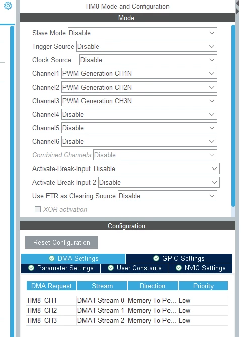

When generating Code for STM32H753IIKx I recently stumbled across unexpected behaviour in Cube IDE V1.5.0. I'm using the processor Pins PH13-PH15 in order to output a PWM Signal from the N-Outputs of Timer 8 (CH1N1-3). However no correlating signals were observed.
My timer initialization:

Cube IDE Setting:
0693W000007CyakQAC.pngFurther investigation showed, that registers for controlling the driver stage were not set accordingly in the peripheral. Only the complementary outputs of the PWM stage were enabled (CH1-3).
Writing to the registers manually later on (outside of the auto-generated codeblock) solved the issue:
htim8.Instance->CCER = (1UL << 2) | (1UL << 6) | (1UL << 10);
Is this a bug or are there underlying mechanics which I'm not realizing?

If I well catch, you want only negative or positive + negatiev to control 6 mosfets with dead time? If second, you ahve to enable them in CubeMX.

The timer is not used for any kind of bridge,... where dead time would be required. We just have a PCB where a RGB LED is routed to the PWM Pins. R, G and B to one Timer channel Pin. Not a huge deal, but I was just wondering what might be wrong here.

 * @brief Enables or disables the TIM Capture Compare Channel xN.
 * @param TIMx to select the TIM peripheral
 * @param Channel: specifies the TIM Channel
 * This parameter can be one of the following values:
 * @arg TIM_Channel_1: TIM Channel 1
 * @arg TIM_Channel_2: TIM Channel 2
 * @arg TIM_Channel_3: TIM Channel 3
 * @param ChannelNState: specifies the TIM Channel CCxNE bit new state.
 * This parameter can be: TIM_CCxN_ENABLE or TIM_CCxN_Disable.
 * @retval None
static void TIM_CCxNChannelCmd(TIM_TypeDef* TIMx, uint32_t Channel, uint32_t ChannelNState)
That's quoting from STM32Cube_FW_H7_V1.3.0\Drivers\STM32H7xx_HAL_Driver\Src\stm32h7xx_hal_tim_ex.c . I don't Cube at all, so don't know if this can be somehow clicked in CubeMX.
