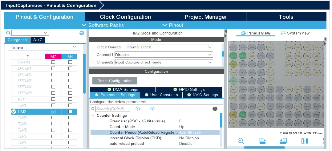

Timer(32bit) Inputcapture
STM32H745i Discovery kit :
In this board TIM2/5 are 16/32 bit  timers when am going to configure in cubeIDE there Prescalar is 16bit  . How can  i use 32bit timer ??  and in this board input pin terminations are very crucial  ?? Any help would be thankfull .

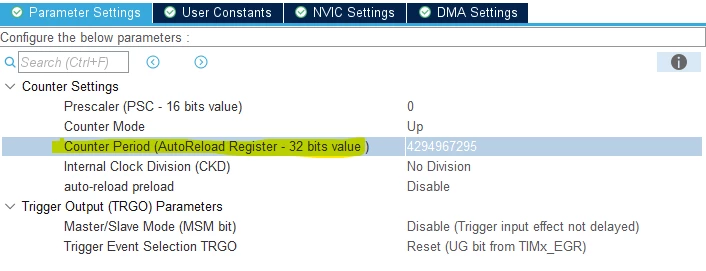

    Hello SA V.1,
    Your Timers 2 and 5 are 32bits timers as you can see below:
    The prescaler on the other hand is 16bits and is there to divide your counter period if needed.
    Regards,
    Stassen

    Bellow  is callback function but  IC_Value1  and  IC_Value2  bothn always 0 so program counter goes to error handler  why happening like this ??TIC.jpj.png
    void HAL_TIM_IC_CaptureCallback(TIM_HandleTypeDef *htim)
    if (htim->Channel == HAL_TIM_ACTIVE_CHANNEL_2) // if interrput source is channel 1
    if (Is_First_Captured==0) // is the first value captured ?
    IC_Value1 = HAL_TIM_ReadCapturedValue(htim, TIM_CHANNEL_2); // capture the first value
    Is_First_Captured =1; // set the first value captured as true
    else if (Is_First_Captured) // if the first is captured
    IC_Value2 = HAL_TIM_ReadCapturedValue(htim, TIM_CHANNEL_2); // capture second value
    if (IC_Value2 > IC_Value1)
    Difference = IC_Value2-IC_Value1; // calculate the difference
    else if (IC_Value2 < IC_Value1)
    Difference = ((0xffffffff-IC_Value1)+IC_Value2) +1;
    else
    Error_Handler();
