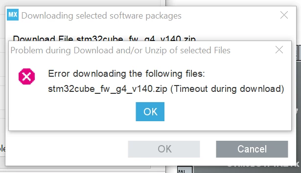

Timeout downloading software packages
When trying to create a new project with the NUCLEO-G474RE board I regularly get the error in the attached image. The project then consists of only the .ioc file and Cube crashes when trying to generate code.
Note that I have no issues creating a project for the NUCLEO-L496ZG board for example.

Hello @Matthias Noé​ ,
This seems like a network issue. Could you download the package directly from here https://www.st.com/en/embedded-software/stm32cubeg4.html and install it manually.

Hello @SBEN .2​ ,
thank you for the advice and the link. I had no issues downloading the package.
