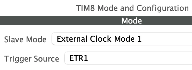

    Thankyou for your insights and patience. I managed to get what I wanted. The two external connections were the key:
    My configuration is different as I'm using ETR with trigger polarity inverted:

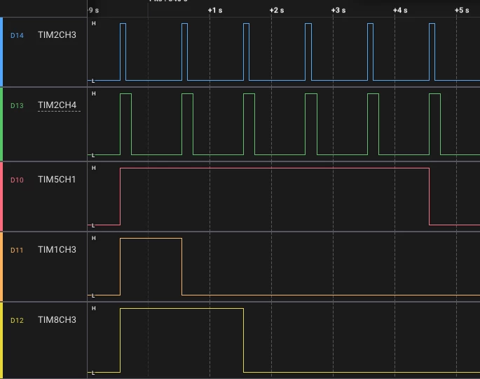

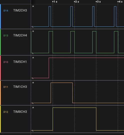

    I connected unused channels from each timer to see it operation visibly. The compare 3 and 4 have the same values that compare1 and compare2 have for TIM2. The ARR match and counter rollover should be what triggers TIM5. By looking at the waveforms for when the three connected timers (TIM1, TIM5, TIM8), we can see that they all change at the same time as the leading edge of TIM2 output channels. It seems that all the counters are driven by the overflow and the compares do nothing. Compare 1 falling edge is when the compare 1 matches the CNT and this is when TIM1 should increment. Compare 2 falling edge is when TIM8 should increment.

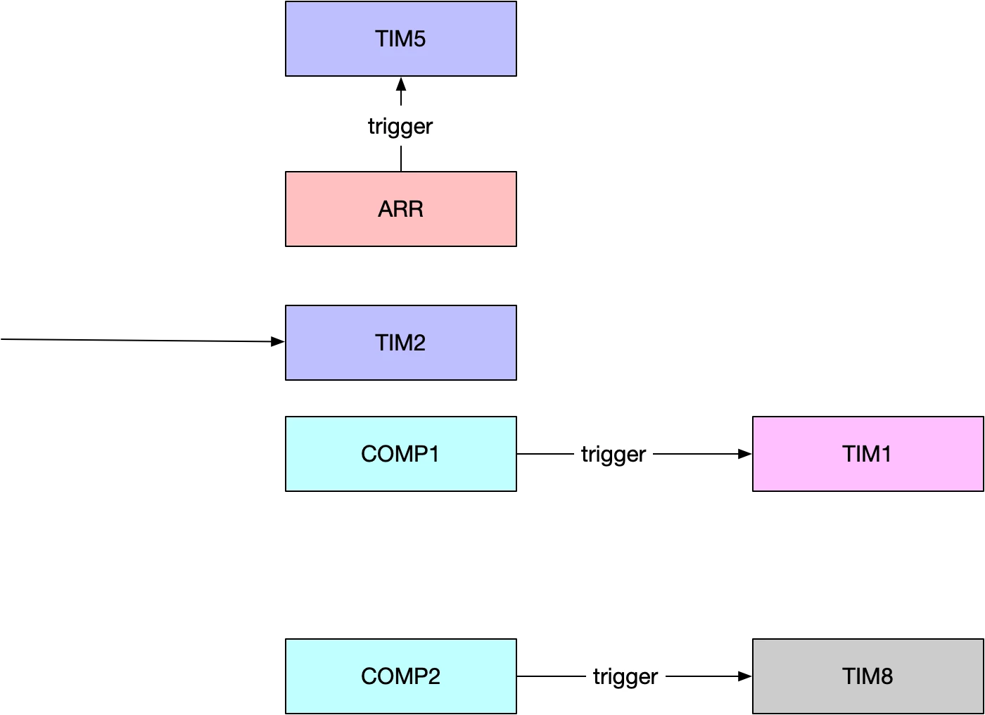

    This is a block diagram of the design:
