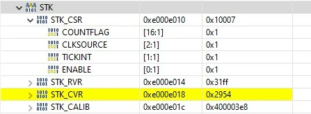

I have a problem after jump from application to my custom Bootloader.
This the micro code: STM32G071KBU3.
I correctly jump from application to Bootloader, but after the jump I don't get anymore interrupt from tick.
I add an information: if I run directly the Bootloader from debug I correctly get interrupt from tick.
Here the code I use for the jump.

    About the regsters STK:
    STK_CVR change his value going step by step in debug.
    STK_CSR->COUNT_FLAG from 0 goes to 1 but going on with the debug remain always high.
    It is proven by the breakpoint I put inside the interrupt routine. I never reach the breakpoint.
    I attach a screenshot of the registers. The tick interrupt exeption is enabled.

    DAUSILIAuthor
    August 6, 2023
    Thank you for your reply.
    The problem was SCB->VTOR. The vector table was not aligned. In the apllication the vector table start address is at 0x08008000. In bootloader execution on 0x08000000. On the Bootloader I have to make explicit the offset that is 0 by SCB->VTOR. Otherwise if I come from Application the vector table address is still 0x08008000 after the jump.
