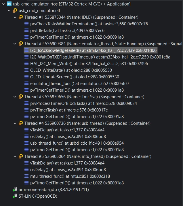

Thread awareness debugging in FreeRTOS [STM32CubeIDE 1.1.0 has a bug for using "-rtos FreeRTOS" on ST-LINK(OpenOCD)].
  • October 23, 2019
  • 31 replies
  • 16312 views
In STM32CubeIDE 1.0.2, after I added '-c "$_TARGETNAME configure -rtos FreeRTOS"' to 'OpenOCD Options', I could debug FreeRTOS's target with threading mode.
But, in STM32CubeIDE 1.1.0, even if I set same settings to 'OpenOCD Options', I could not debug with threading mode. In this version, openocd outputs 'Error: No symbols for FreeRTOS'.
Could you please check about this?

I checked this on CubeIDE 1.3.1 and it is working
KOkun.1048
June 24, 2020
Please add "-Wl,-undefined=uxTopUsedPriority" to your linker options.

Panometric
September 4, 2020
Actually, I remember I used to always get "Error allocating memory for .. threads" but the thread aware debugger worked anyway.
Curiously, I am not seeing it now, but I do see: "Error: Error reading thread list item object in FreeRTOS thread list"
I think it;s because the initial trap is before the OS kernel is running, so you will not see threads. Set a breakpoint in a thread and run, you are probably fine.

JBeca.1
September 7, 2020
ok, I think I found the "solution".
I had enabled the optimization option "Os" (for size), and I changed to "Og" (for debug), and debugger stop to all breakpoints always.
Thanks for the support!
Jordi

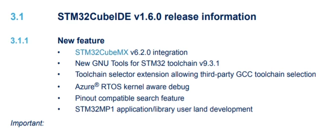

Brian TIDAL
February 9, 2021
STM32CubeIDE version >= 1.5.0 has now the support for FreeRTOS™ thread-aware debugging.
See chapter 6 (RTOS-aware debugging) in STM32CubeIDE user guide UM2609
Rgds
BT
fronders
April 14, 2021
@KOkun.1048​ Thanks for your guide!!
@Brian TIDAL_O​ you're kidding right? The issue still exists in 1.6.1
For FreeRTOS only RTOS-aware viewers have been added (Task list, Timers, Queues and Semaphore) - while no thread-aware debugging has been introduced (when you can simultaneously view stacks of all threads).
Please don't desinform people.
While the hack above works only with OpenOCD w STLink, it does not support STLink GDB Server yet.
Brian TIDAL
April 14, 2021
HI @fronders​
One of the common definition of Thread aware debugging is : "Thread aware debugging specifies the capability of a debugger to show all existing threads / tasks of the RTOS, running on the embedded system when the target system is halted by the debugger." In that sense, STM32CubeIDE since version 1.5.0 has the support for FreeRTOS™ thread-aware debugging. The STM32CubeIDE user guide UM2609 gives comprehensive information about the various views and the way to use this feature.
I believe each developer has his own definition of what is thread-aware debugging  and has his own expectations about what thread-aware debugging should provide.
I am sorry that the current level of RTOS-aware debugging features integrated in STM32CubeIDE does not meet your expectations.
Rgds
BT
