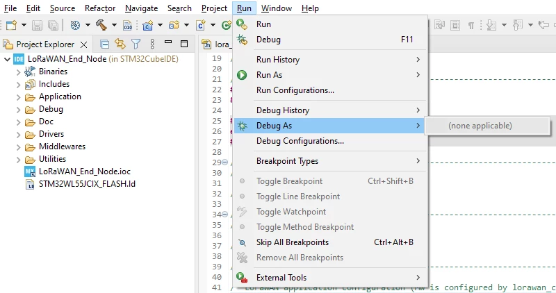

This is not exactly an MCU question. With STM32CubeIDE I've got a wrong set of Launch Configuration prototypes on all projects in a workspace.
C/C++ Unit is missing, also STM32 Cortex-M C/C++ Application. Deleting and creating a project from scratch won't help. How can one get a missing Launch Configuration prototype?

Hi I am facing the same problem, following the lorawan stm32 tutorial on youtube (cant post link), but the STM32 Cortex-M C/C++ Application is missing.
Please advise

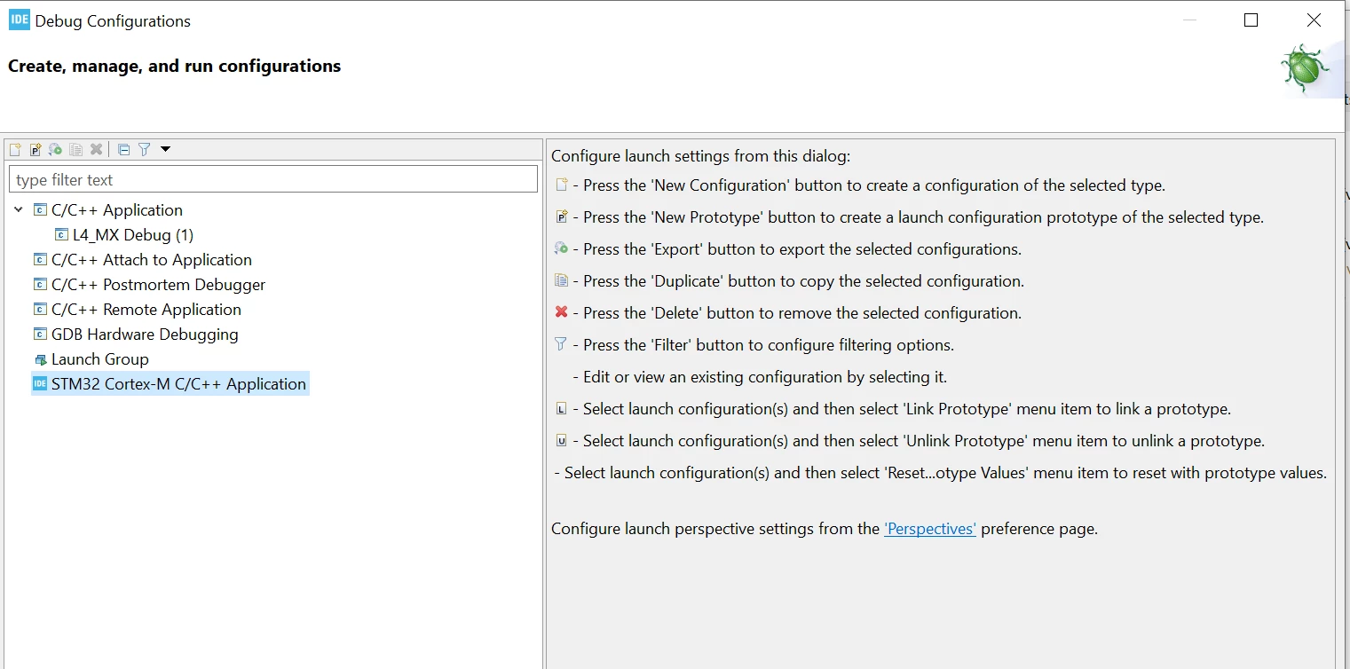

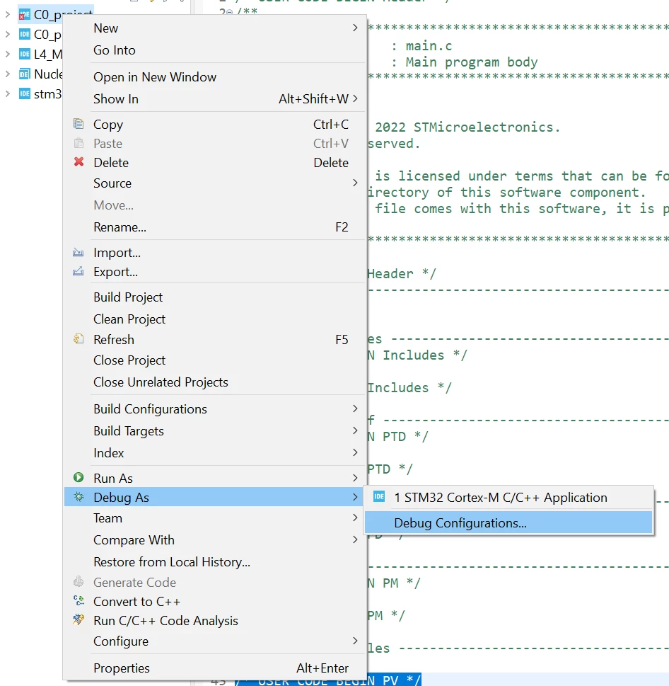

I don't think you have an option there because you don't have a debug configuration. If you right click the project in the project explorer you should get the menu to open the debug configurations:
0693W00000NqqDSQAZ.pngFrom there you can double click on the "STM32 Cortex-M C/C++ Application" to create your debug configuration:
