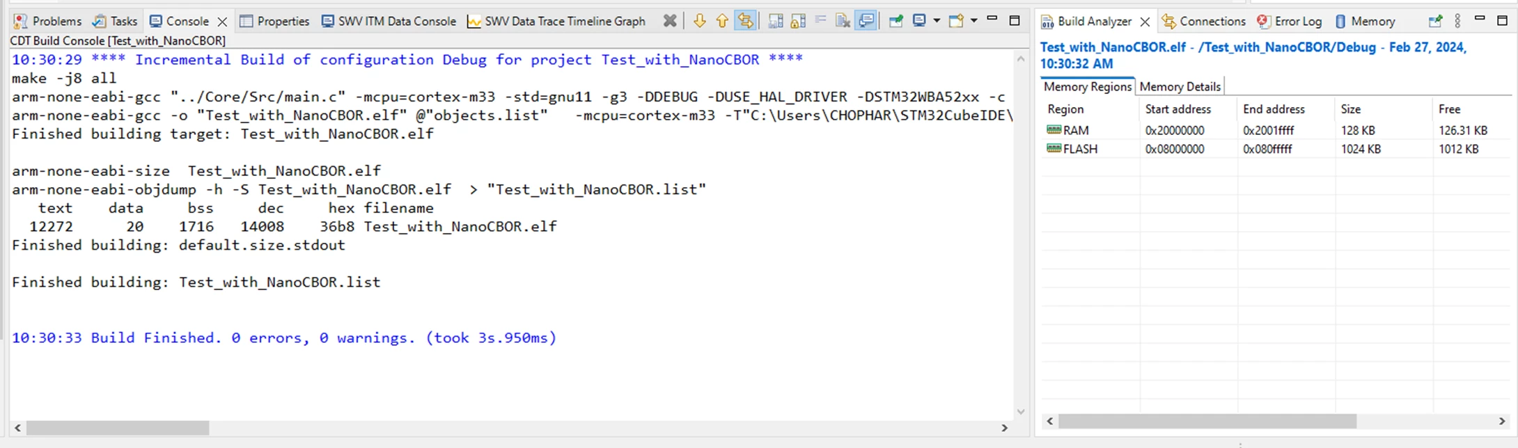

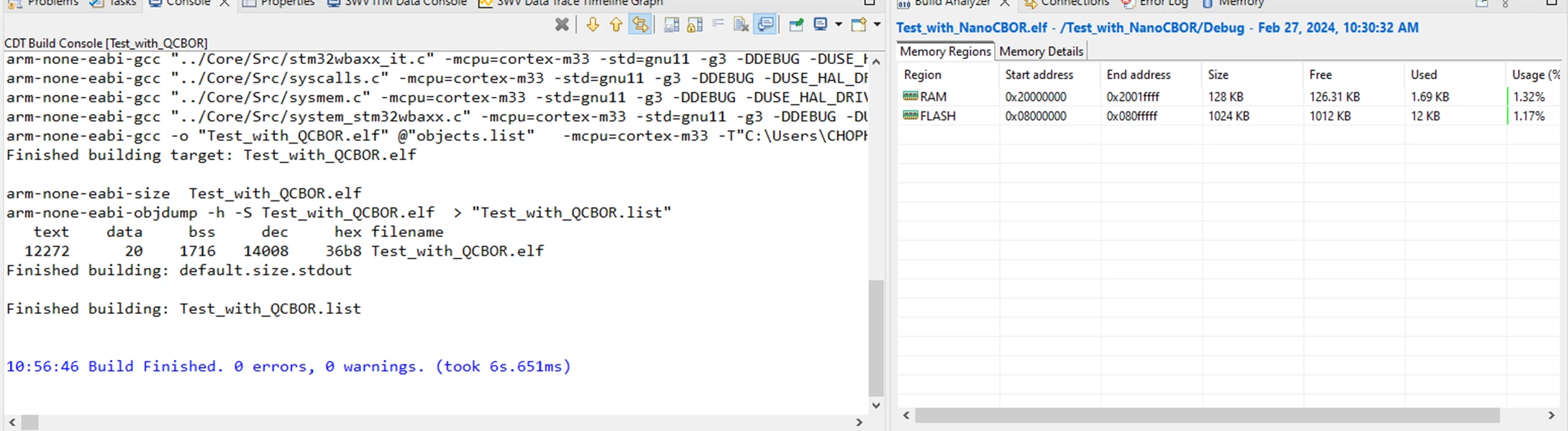

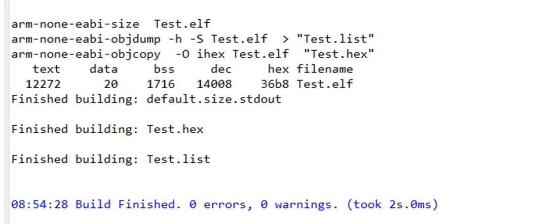

I am trying to compare a third party libraries size on my STM32 project.
Methodology
  • Firstly, i build a project without including a third party library and build it.
  • Secondly i build a project after including a third party library and compare memory usage with build analyzer and surprisingly i get the same result.
How i can know the exact memory size used by library?

Without Library build project.Without Library build project.

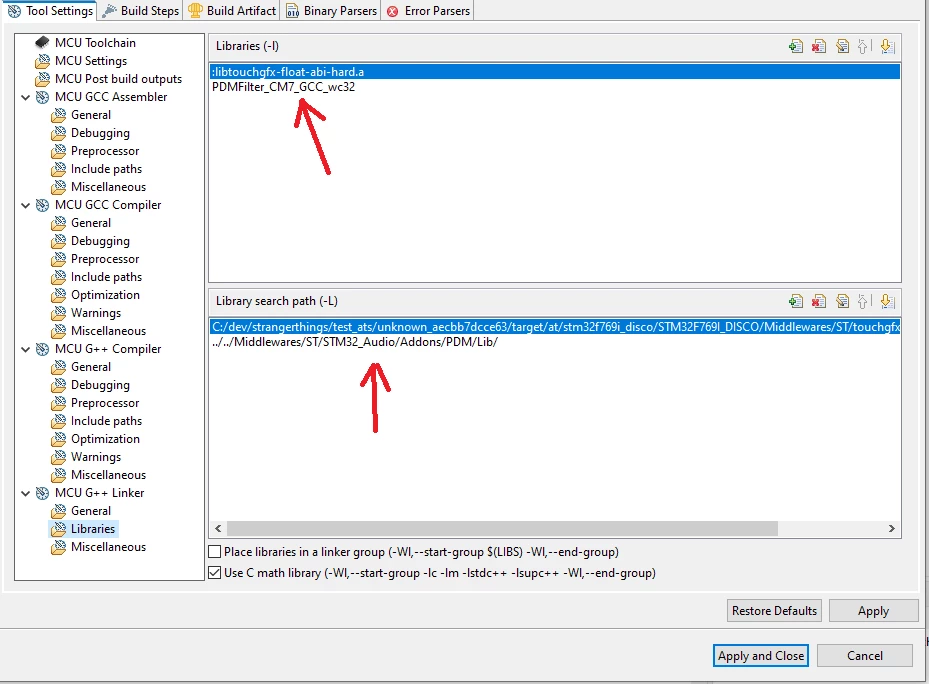

Since we don't have a visibility of what kind of library you are using we cannot help you.
If you have a .a library file you need to add it in library section as shown before.

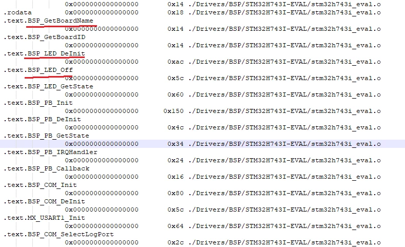

You have to check the map file (.map in \STM32CubeIDE\Debug): so are you really calling the library APIs?
Example:
Also when you say you add a library, you mean a pre-build library or in source files? Because in the first case you need to add the library and its path here:

I just include the library at main.C file. i didn't use any function of the library.
mƎALLEm
February 28, 2024
If you just included the .h file without any call from the library, as you you didn't add anything. So you must call something from the library.
