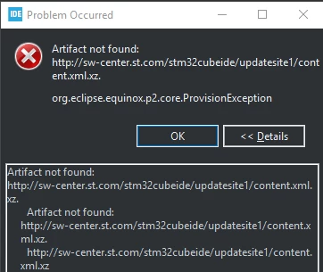

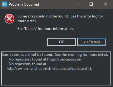

Hi Julien,
This is actually occurring in the STMCUBEIDE when I go to Help> Check for updates.
I get this error:-
Thanks James

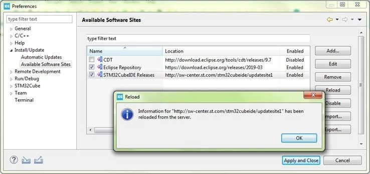

When I go into the list of available sites and reload i get this:-
Julien D
June 19, 2019
Definitively clearing you cache will solve the issue.

If you are behind a proxy make sure that your settings are correctly set, the reload button may help to validate them.
Otherwise I suggest you to clear your p2 cache by deleting the following folder, and try again Help > Check for updates:
INSTALL_LOCATION\STM32CubeIDE\p2\org.eclipse.equinox.p2.repository\cache

Hi Julien,
I deleted the files from the Cache and that seems to have done the trick.
Thank you for your help.
