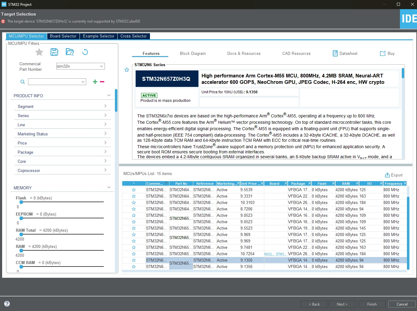

I selected the processor in CUBE IDE to see how much space the sd card and h264 codes will take up in ram and memory on the STM32N657Z0HxQ processor, but I got the error “The target device ‘STM32N657Z0HxQ’ is currently not supported by STM32CubeIDE”. What should I do?

@hamzdmr wrote:
I am currently using version 1.16.1,
1.16.1 does not support STM32N6 products. It was added in the V1.17.0:

Andrew Neil
Feb 17, 2025 10:12 AM UTC
You didn't say what version you're using!
The STM32N series is pretty new - so you'll certainly need to be on the latest.
hamzdmrAuthor
Feb 17, 2025 12:47 PM UTC
You are right, I am currently using version 1.16.1, I thought the check updates I made from the Help section would work. I will update the application itself and inform you.

With STM32CubeIDE 1.17.0, I cannot see that issue. Are you sure you are using that version?
