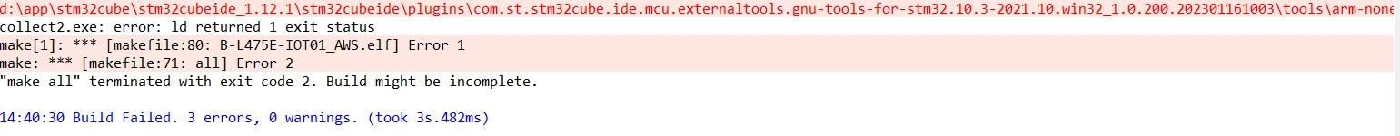

When I build the D:\Desktop\stm32Cube\en.x-cube-aws-v1-4-2\STM32CubeExpansion_Cloud_AWS_V1.4.2\Projects\B-L475E-IOT01A , it show me the error:
d:\app\stm32cube\stm32cubeide_1.12.1\stm32cubeide\plugins\com.st.stm32cube.ide.mcu.externaltools.gnu-tools-for-stm32.10.3-2021.10.win32_1.0.200.202301161003\tools\arm-none-eabi\bin\ld.exe: cannot use executable file '../../../../../BootLoader_OSC/2_Images_SBSFU/SW4STM32/B-L475E-IOT01_2_Images_SBSFU/Debug\se_interface_app.o' as input to a link.
Though I add the .o into to PATH, it still error. How to deal with it?

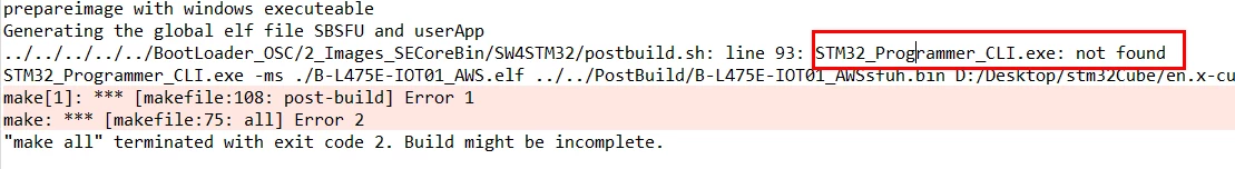

I found the solution to solved it, click the Window->preferences->STM32Cube->Toolchain Manager. My default toolchain is 10.3-2021.10, it build the project will make error, so, I install the 7-2018 or 9-2020. And set it as default, it can solved the issue, but I show a new error when compile the following:
_legacyfs_online_stmicro_images_0693W00000bkNfbQAE.pngAre there ways to solve it ?

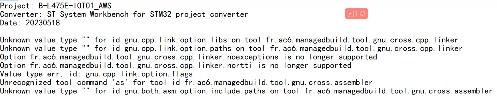

I have tried this, but it still show the same error. And here is some requires in " B-L475E-IOT01_AWS_converter.log ":
_legacyfs_online_stmicro_images_0693W00000bkKqWQAU.pngdoes it matter ?

here is the full error:
"d:\app\stm32cube\stm32cubeide_1.12.1\stm32cubeide\plugins\com.st.stm32cube.ide.mcu.externaltools.gnu-tools-for-stm32.10.3-2021.10.win32_1.0.200.202301161003\tools\arm-none-eabi\bin\ld.exe: cannot use executable file '../../../../../BootLoader_OSC/2_Images_SBSFU/SW4STM32/B-L475E-IOT01_2_Images_SBSFU/Debug\se_interface_app.o' as input to a link"
It's the same as it was.

I totaly sovled all issue, about the STM32_Programmer_CLT, I just need to install an app(Programm software) from st into the path as postbuild.sh it writes(just as default path when it is installing). Then it will build successfully. Thanks a lot for your responses:smiling_face_with_smiling_eyes:
