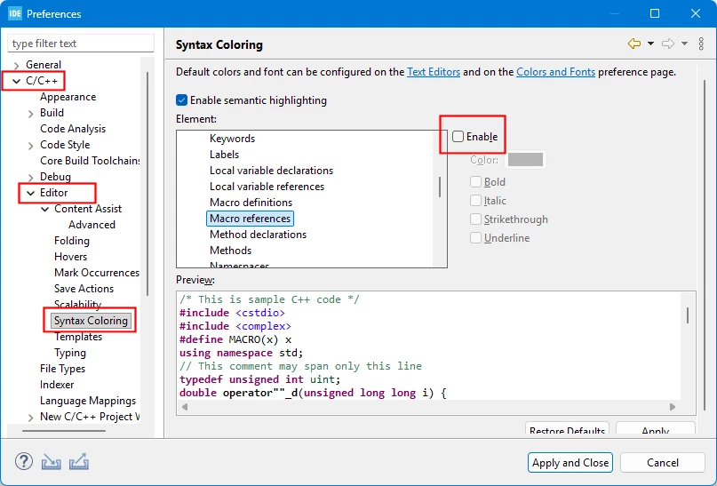

​@STuser2  - The setting is in Window > Preferences:

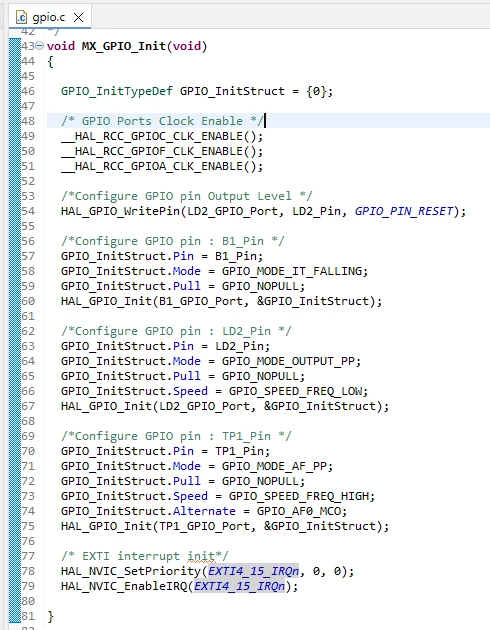

I realized that only enums are getting highlighted.

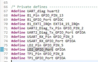

The below two are macros
The above SOFTWARE_VER  is an enum. Is it possible to highlight the #defines also like above?

Having said that, I see in my own projects:
and it is, indeed, only the enums which are getting highlighted!

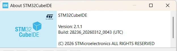

CubeIDE Version: 2.1.1; Build: 28236_20260312_0043 (UTC)

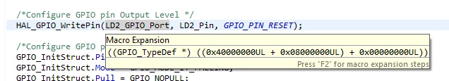

The IDE does recognise that they are macros:
Andrew Neil
STuser2Author
Senior III
October 26, 2026
Thank you very much.
