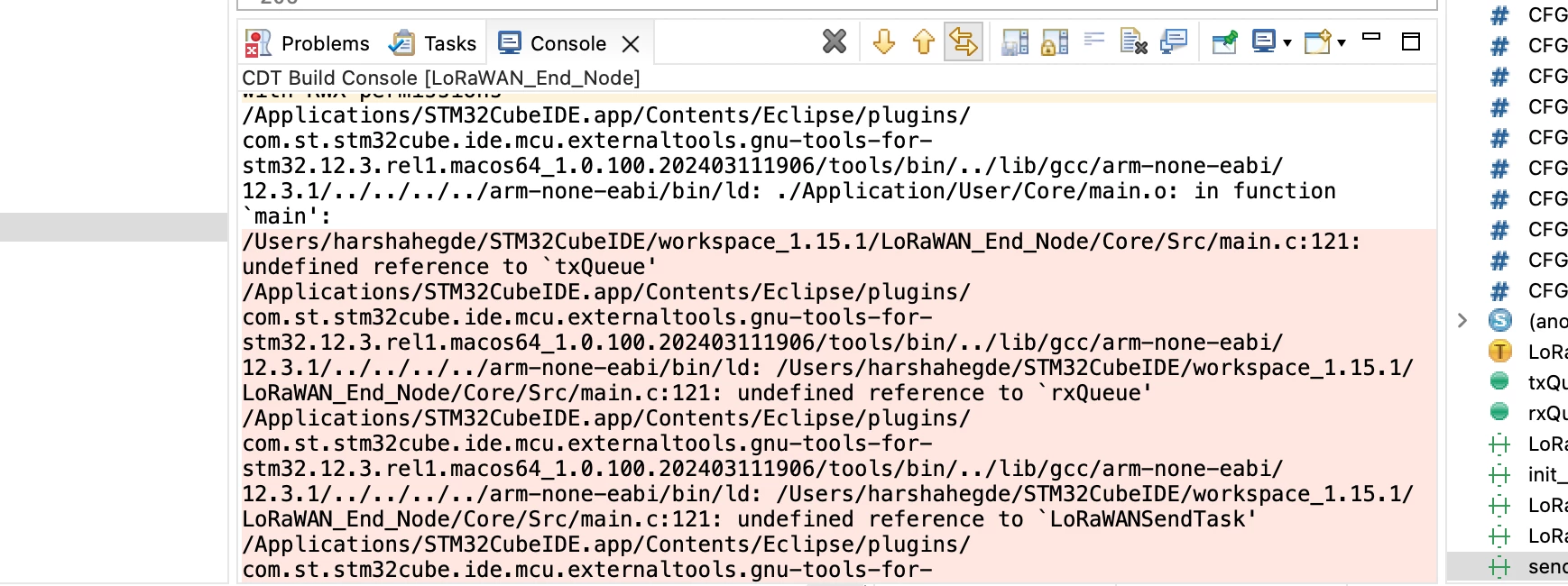

The functions in the header file not accesible getting undefined reference to.
I'm using the Lorawan_End_Node. I wrote a function in lora_app.c file and declared the same in lora_app.h file.
But when I use the same in the main file I get undefined reference to.

    Show the exact log with the error.
    The .h must be included.
    The .c must be in your project and be compiled.
    The compiler output .o of the .c must be linked.
    Mixing C and C++ may cause trouble.
    hth

    Thanks for the reply @KnarfB
    My main.c file

     LmHandlerParams_t params;
     params.ActiveRegion = LORAMAC_REGION_EU868;
     params.AdrEnable = LORAWAN_ADR_ON;
     params.TxDatarate = DR_0;
     params.PublicNetworkEnable = true;
     params.DutyCycleEnabled = false;
     LmHandlerConfigure(&params);
     // Join the LoRaWAN network
     LmHandlerJoin();
     // Wait for the join to succeed
     while (!LmHandlerJoinStatus()) {
     vTaskDelay(pdMS_TO_TICKS(1000));
    void LoRaWANSendTask(void *pvParameters) {
     LoRaWANMessage_t message;
     while (1) {
     if (xQueueReceive(txQueue, &message, portMAX_DELAY) == pdPASS) {
     // Send message
     LmHandlerAppData_t appData;
     appData.Port = message.port;
     appData.BufferSize = message.bufferSize;
     appData.Buffer = message.buffer;
     LmHandlerSend(&appData, LORAWAN_CONFIRMED_MSG);
    void LoRaWANReceiveTask(void *pvParameters) {
     while (1) {
     // Wait for a message
     if (LmHandlerReceive(&appData)) {
     // Copy received data into message structure
     message.port = appData.Port;
     message.bufferSize = appData.BufferSize;
     memcpy(message.buffer, appData.Buffer, appData.BufferSize);
     // Send the message to the RX queue
     xQueueSend(rxQueue, &message, portMAX_DELAY);
     vTaskDelay(pdMS_TO_TICKS(1000)); // Check for messages every second
    void send_message(uint8_t *data, uint8_t size, uint8_t port) {
     message.port = port;
     message.bufferSize = size;
     memcpy(message.buffer, data, size);
     xQueueSend(txQueue, &message, portMAX_DELAY);
    Error:
    /workspace_1.15.1/LoRaWAN_End_Node/Core/Src/main.c:121: undefined reference to `txQueue'
    A detailed error image is attached.
    Thanks!!
    KnarfB
    July 27, 2024
    Linker (ld) error.
    Check that lora_app.c is in the list of source files.
    hth
    KnarfB
