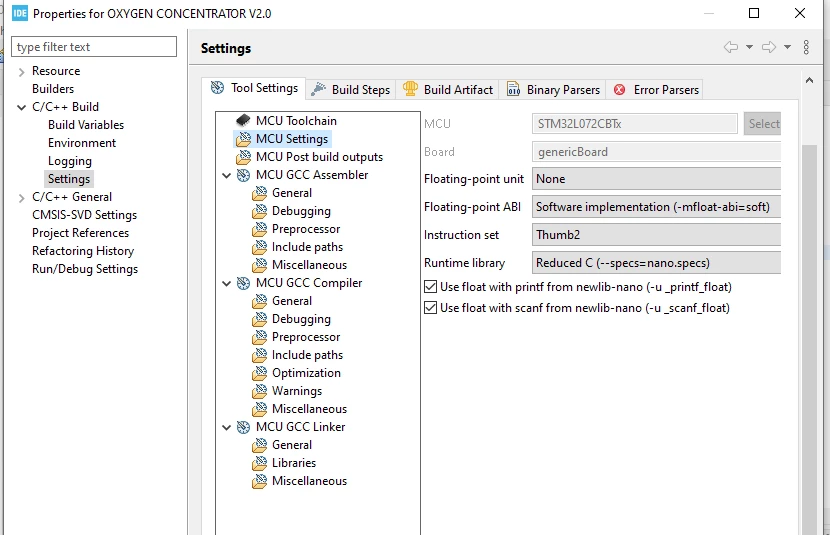

The %f floating point is not working properly in sprintf in my code, it put some garbage value
Hi all i am facing a problem with sprintf . the %u,%d are working fine in sprintf but the %f is throwing some garbage value in my code any thoughts please share me here. i have shared a snippet of my code over here.
float Channel_5_Volt;
Channel_5_Volt = ((float)Adc_5_Data/4095)*3.3;
sprintf(Buf,"adc0 %f \r\n", Channel_5_Volt);
HAL_UART_Transmit(&huart1,Buf, sizeof(Buf), 100);

NJP.1Best answer
Dec 21, 2021 1:04 AM UTC
Thankyou for the reply I have not added the two function and now i added it and also checked it is working fine. Thankyou

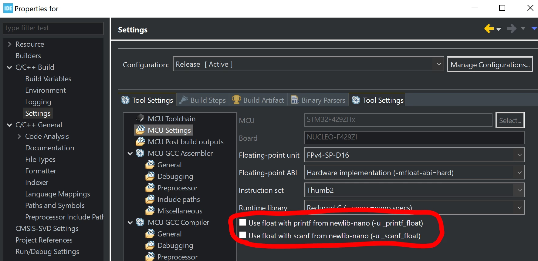

Did you enable printf support in your program?

NJP.1
NJP.1Author
Dec 21, 2021 1:14 AM UTC
As tdk said check the two option in the mcu settings.
