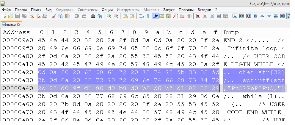

I have a problem with the output in cp1251 encoding.
settings that I made:
  1. Window--->Preferences--->General--->Workspace ---> entered CP1251 ---> next apple and close
  2. project ---> properties ---> Resourse ---> entered cp1251 ---> next apple and close
  3. Add code :
char str[32];
 sprintf(str,"Привет");
4. rebuild project
5.I didn't get any errors
I opened it in notepad in the hex editor and saw the following words for the word "привет":
d0 9f d1 80 d0 b8 d0 b2 d0 b5 d1 82

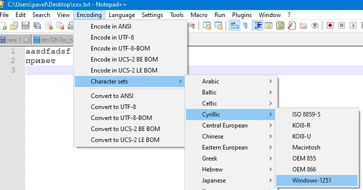

Now switch HEX mode off, select encoding 1251 and you will see the text. It is in CP1251.
