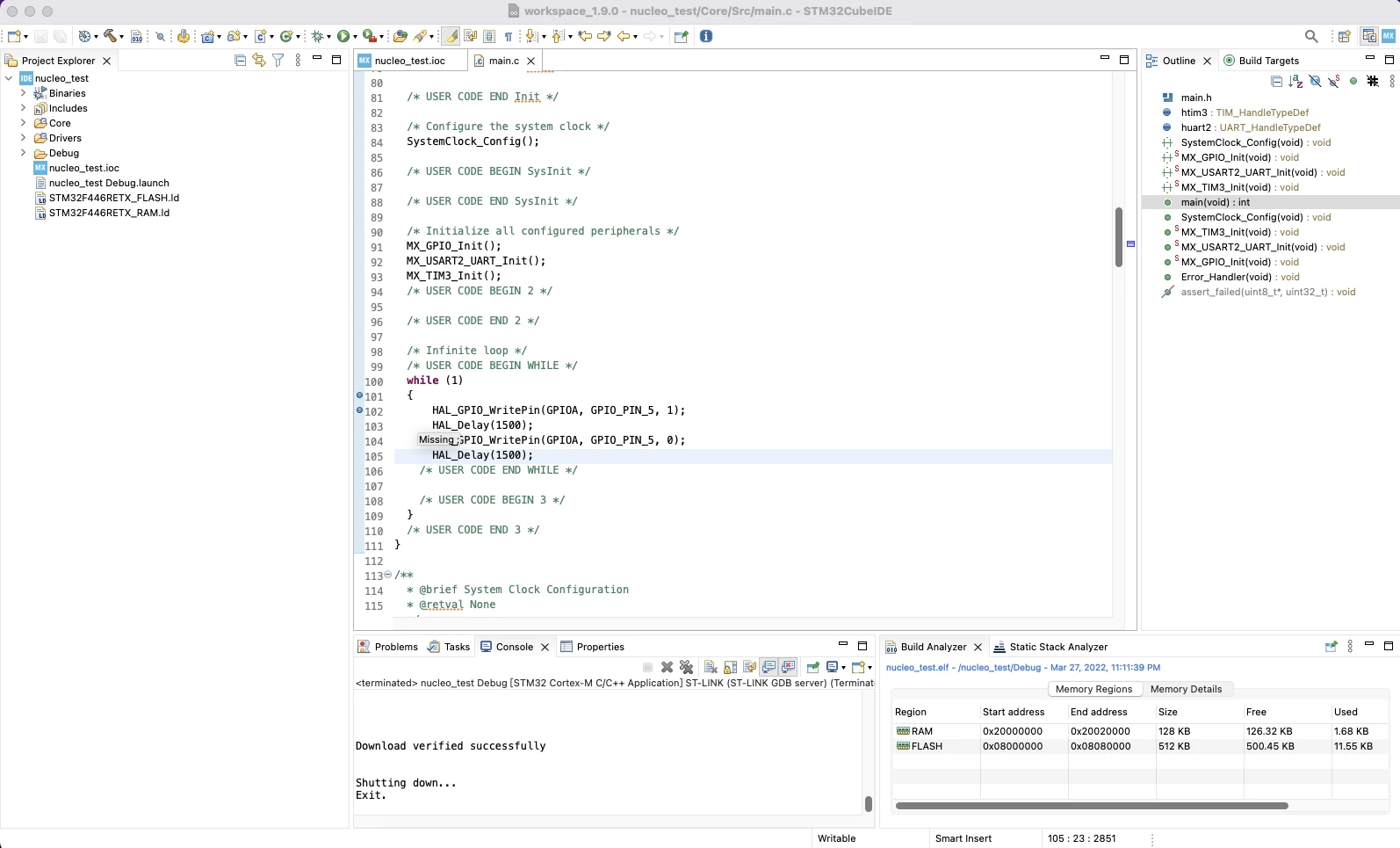

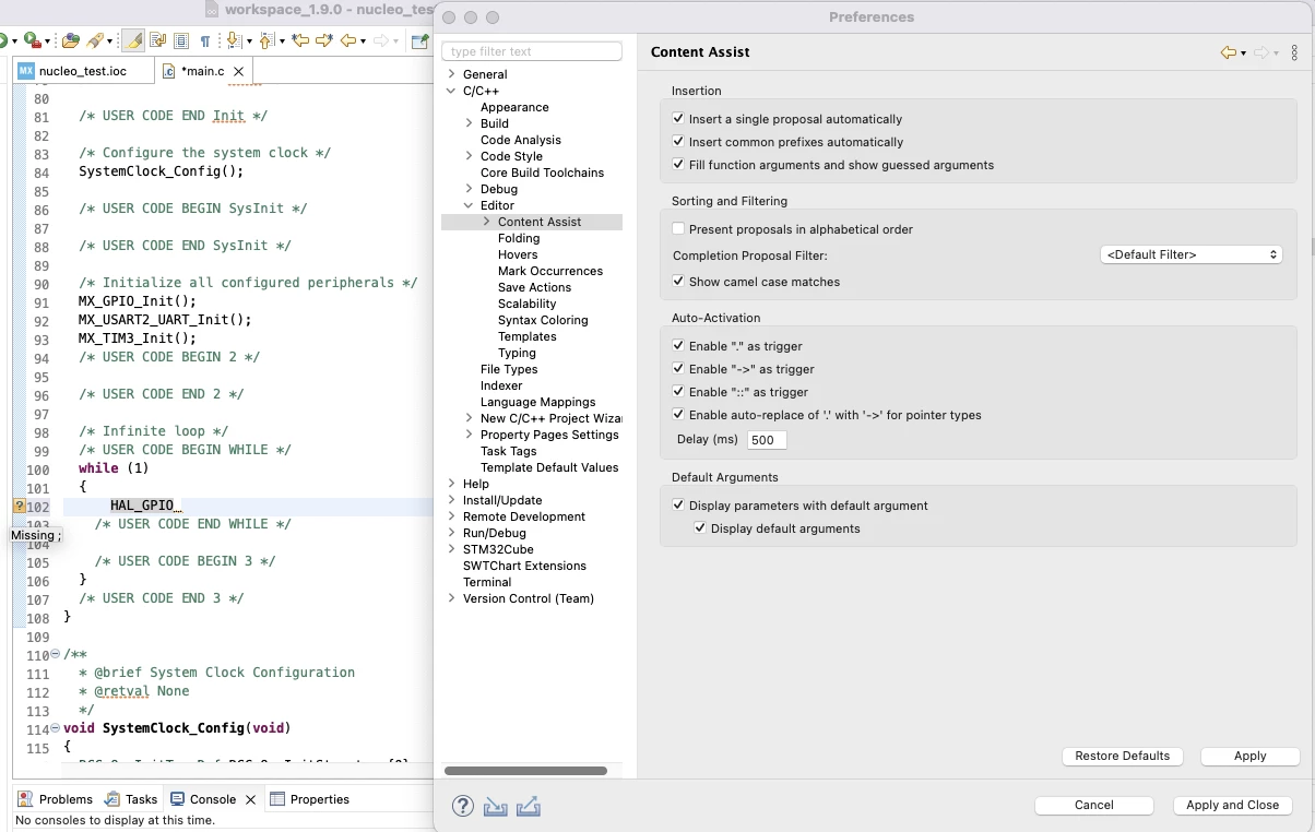

I am using macOS and I found that the content assist is not working when I press either "ctrl + space" or "command + space".
Is there any setting I missed?

I found that the answer. It is a mistake... For macOS, content assist is option + / . Thanks a lot!

Does the project build? If you press F3 while on a function, does it jump to the definition?
You can try rebuilding the index with Project -> C/C++ Index -> Rebuild...

I pressed F3, nothing happened...
After I rebuilt it, nothing happened as well...
0693W00000LvulLQAR.pngand I tested the LED function. It worked. I think the project has been built, but I do not know why I can not use content assist...
March 28, 2022
Sounds like you need to rebuild the index. Context assist and jump to definition use the same info.

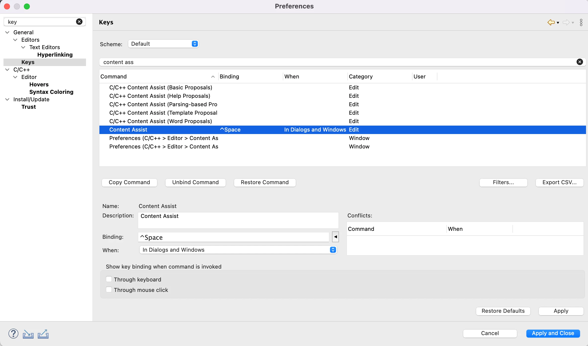

If you prefer another keybind you should be able to change it with the following setting0693W00000LwFYcQAN.png
