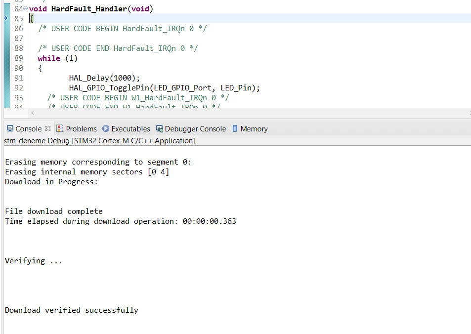

The codes "Download Verified Successfully" but Led of STM32 dont blink, why?
0693W00000JMI5dQAH.pngI do everything like videos but my stm32 don't blink with Cube IDE. By the way its working with Arduino IDE. What is the problem? Thanks for replies.

Have you tried to reset your microcontroller after uploading code? If you are using a nucleo board simply press reset button (also make sure it runs on newest firmware).

Yes i reset microcontroller, changed cables, reset my PC but it didnt change.

You could try to clean the project (right click -> clean project) in the Project Explorer view. Also, with STM32CubeProgrammer standalone you could connect to the board and clean it to be 100% certain that the flash is cleaned before the new debug session.

I did the things that you say but anything changed.

STM32F103C8 ( Blue Pill) and St-link Mini Sir. I tried program with Cube IDE.

Pleas show your pin configuration window, how GPIOs are configured. Also check if LED_GPIO_Port and LED_Pin are connected to the LED on the board you use.

i experienced the same thing.
Download verified successfully. but the blink doesn't work at all.
I tried another bluepill, it worked.
it happened after i unlocked read only protection.
