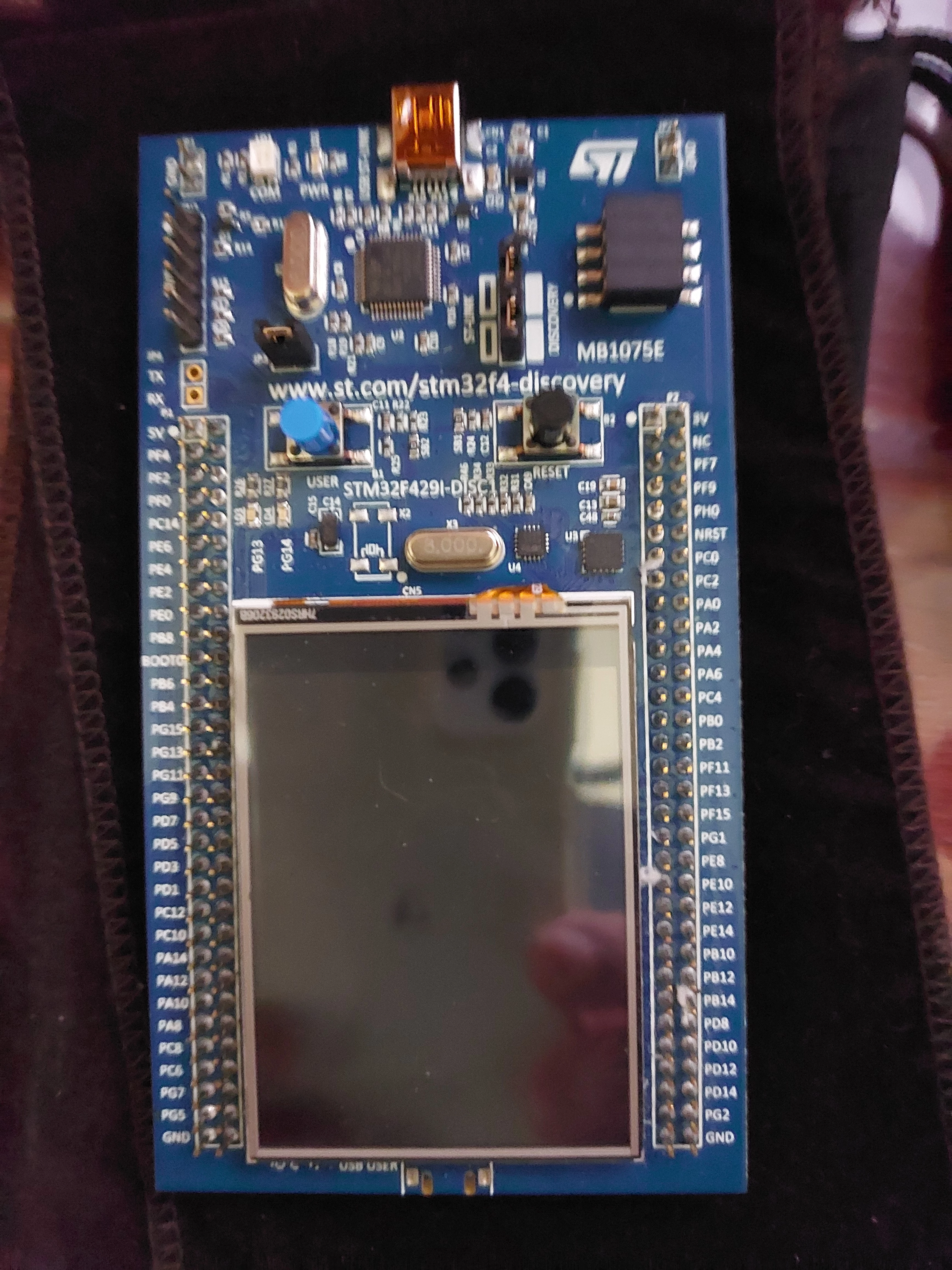

The BSP example for STM32F429I-Disc1 with STM32CubeIde crashes.
Good morning! I have a problem with the STM32F429I-DISC1 board. I bought this board a few weeks ago and with the STMCubeIde software (v. 1.12.0) I downloaded the BSP example for this board together with the STM32CubeF4 package (v. STM32Cube_FW_F4_V1.27.0). After compiling the project and loading it into the board (Run as STM32 C/C++ Application), the execution hangs during the calibration of the touch-screen (activate the colored circle inside the rectangle). I tried with various PCs with Windows 10 Pro (I7 and I5 with 16 GB of RAM) and also on a Linux Kubuntu v.22.04 machine but the anomaly always occurs. Another example (LTDC_Display_2Layers) works correctly. I also tried to use another STM32F429I-DISC1 card but the problem remains. Can anyone enlighten me on this? Thank you!

Hello Alann ,
This BSP example configuration has been running on STMicroelectronics STM32F429I-Discovery RevC board, and in order to run it on STMicroelectronics STM32F429I-Discovery RevD or RevE boards (NB: check your board revision ) , please ensure to add "USE_STM32F429I_DISCOVERY_REVD" define in the toolchain's pre-processor options and download the update fix form github : Update touch calibration to fix inverted touch panel on STM32F429I-DI… · STMicroelectronics/STM32CubeF4@d7fef24 · GitHub

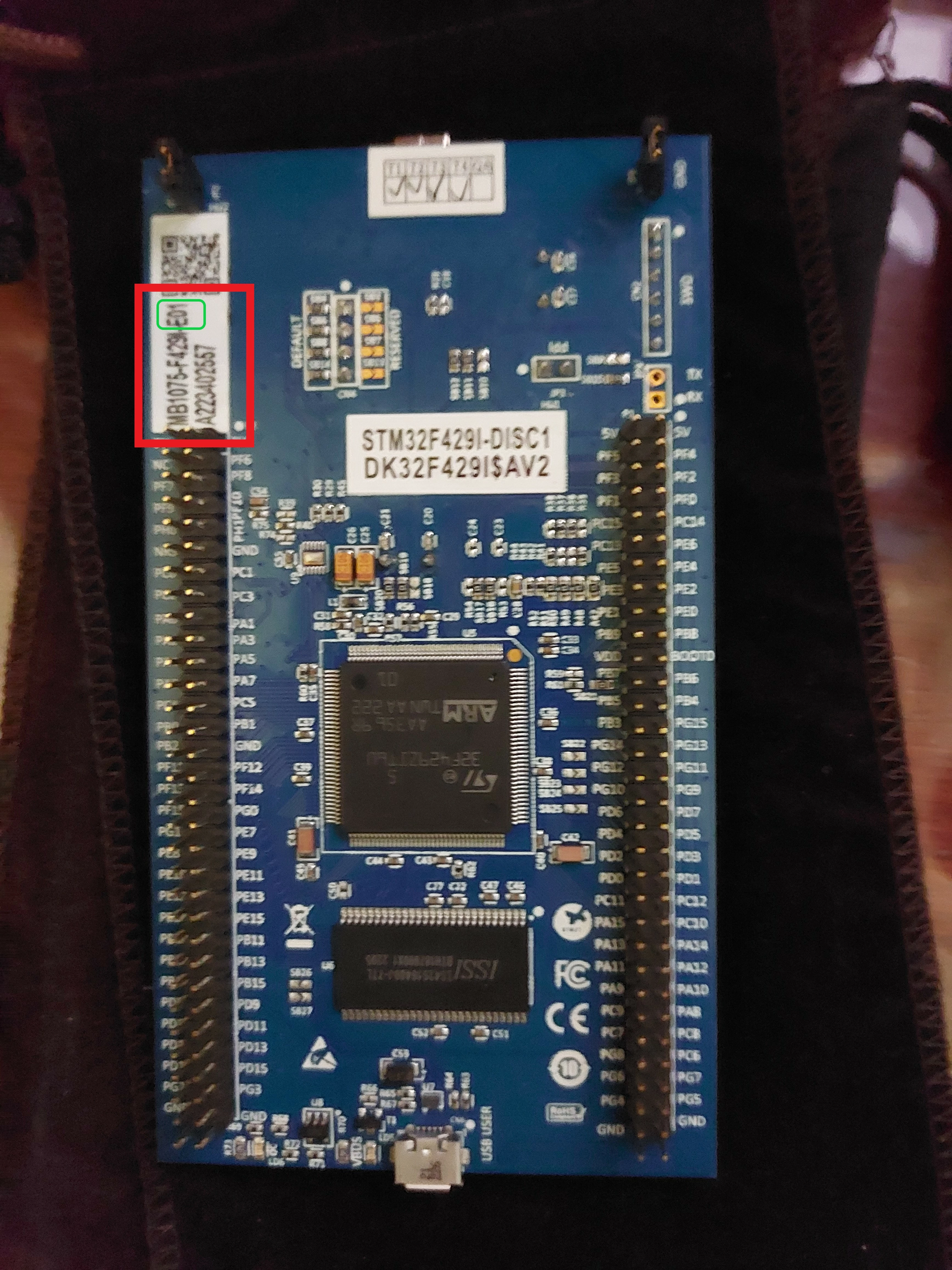

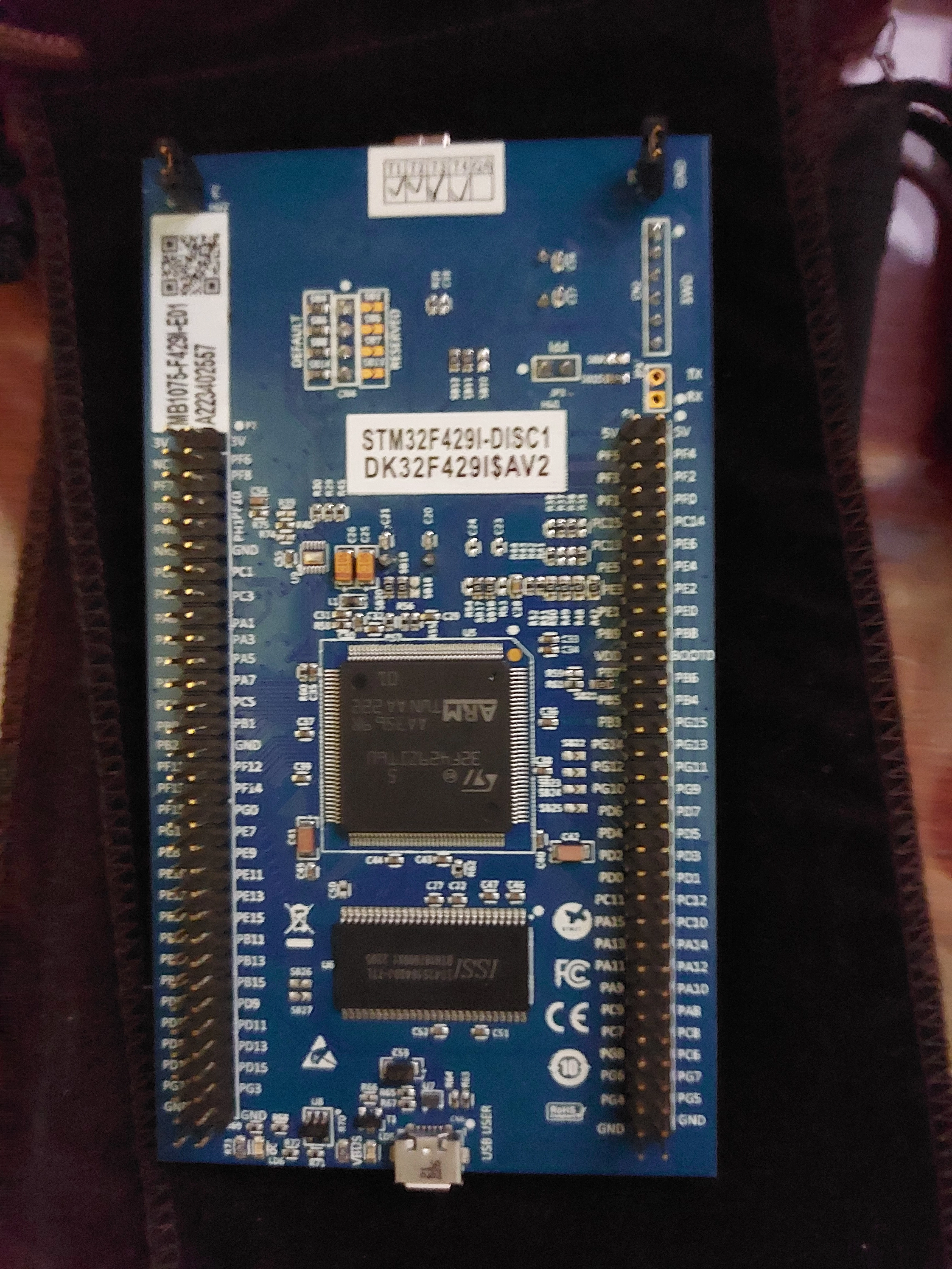

_legacyfs_online_stmicro_images_0693W00000binnXQAQ.pngGood morning and thank you! How do I see the REV of the card? I don't see any indication on the circuit board.

Hi Alann ,
as mentioned on the picture below , your board is STM32F429I-Discovery RevE.
