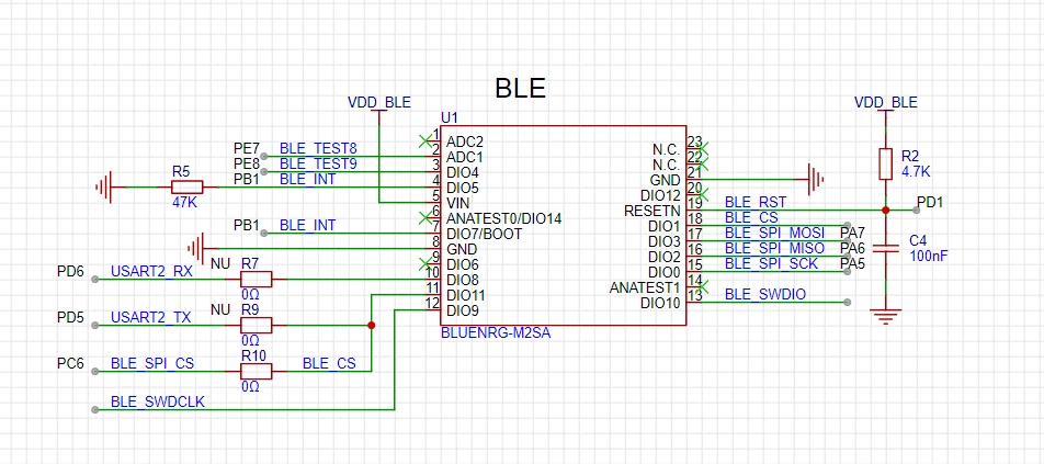

The BLUENRG-M2SA is not responding,code enter goto end_label
I’m porting the DATALOG2 application from
fp-sns-datalog2\STM32CubeFunctionPack_DATALOG2_V3.1.0\Projects\STM32U585AI-STWIN.box\Applications\DATALOG2to the STM32U575VGT6, but I’m running into issues with the Bluetooth functionality during debugging. Does anyone have any suggestions?
The code enters this section:
if (ret_status != (ble_status_t)BLE_STATUS_SUCCESS)
BLE_MANAGER_PRINTF("Error: HCI_LE_SET_SCAN_RESPONSE_DATA [%x]\r\n", ret_status);
goto end_label;
I can erase, read, and program the BLUENRG-M2SA using RF-Flasher Utility v4.5.0, which indicates that the chip is not damaged.
The complete project source code is attached.
The hardware circuit is as follows:
The code is as follows:

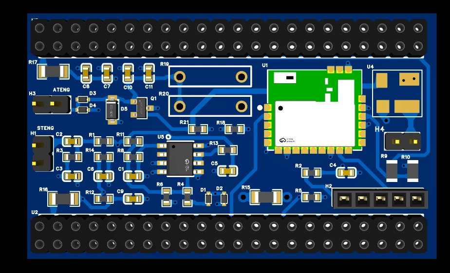

Dec 14, 2025 1:58 AM UTC
my PCB layout is as following, does it led to the above question?
