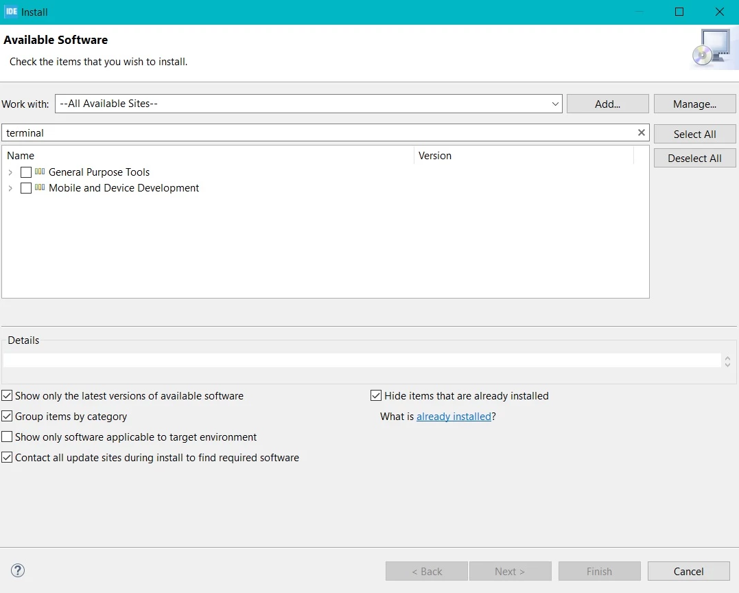

I want to use a terminal to check serial communication. I have tried to install a terminal to my CubeIDE software. I have followed this path:
Help --> Install a new software --> (I have looked for a "terminal" keyword. I have tried to install TM Terminal & TM Terminal Serial Connector Extensions)
But when I tried to install them I have encountered a message like that:

How can I solve this problem?

I solved this problem.

M.umit
M.umitAuthor
July 10, 2020
I have unchecked one of the details part. I don't remember it clearly. It was likely "Show only the latest version of available software". Then, it has run properly.
