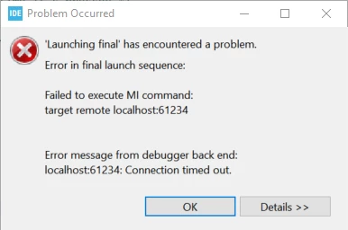

I am programming on the NUCLEO-C031C6 and have some errors debugging the project. I have connected the board with micro-usb as it must. However i get following error message:

    Make sure to update the ST-Link Firmware and ST-Link server software.
    Make sure to use the last release of CubeIDE.
    Check the USB cable and connectors.

    The error has not been resolved, however i do not know if the st-link server is started since i ran the .bat file from the link you provided. However i should only give administrator rights and did not receive any feedback if successfully installed.
    In my FAIL.txt file from the board itself, it states:The interface firmware FAILED to reset/halt the target MCU.
    After disconnecting and reconnecting the Board, the LD1 is constantly red. However after trying to run a project and when the error occurs, it turns constantly green.
    Is it possible, that the connecting micro-usb cable is the issue or is there another way to possible fix it?
