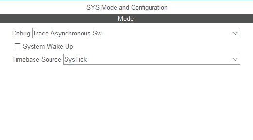

so you stop the cpu and then debug...?
Did you set. enable debug ...low power ?
RB4020Author
Hey!

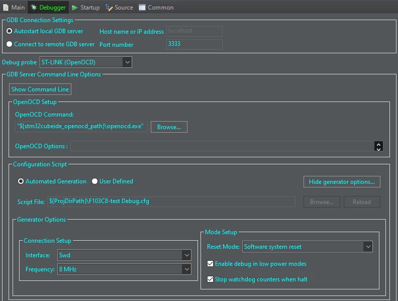

If you see the code, before entering into the Stop2 mode itself the debugger is getting stuck at 'MX_GPIO_Init()' and showing the error "Target not responding, retrying..."
And yeah, I enabled to debug in low power modes as well.
AScha.3
So : did you set/enable debug in Cube/ioc ?
If you set the swd/swc pins to another mode (like analog...) it will break the debug connection.
Set debug on the ioc .
