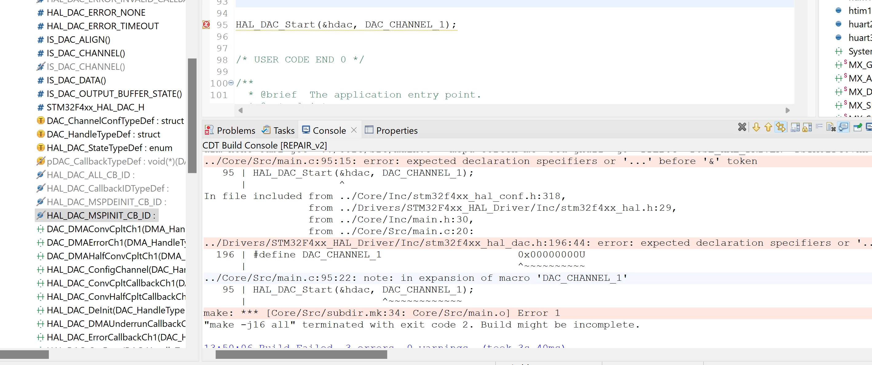

Probably it is a simple question but I got a syntax error of HAL DAC function? Do you have an idea about the problem?
Best answer by AE104
Thank you @KnarfB​ and @Piranha​ for your responses! I fixed the problem with placing the DAC initialization in user code begin_2 section.

There is probably a syntax error above which is not shown or not detectable by the compiler like an extra/missing { or comment or such because the error text talks about a "declaration".
hth

Start fixing the code with the first error, because the rest can be just a consequence of the first one.
