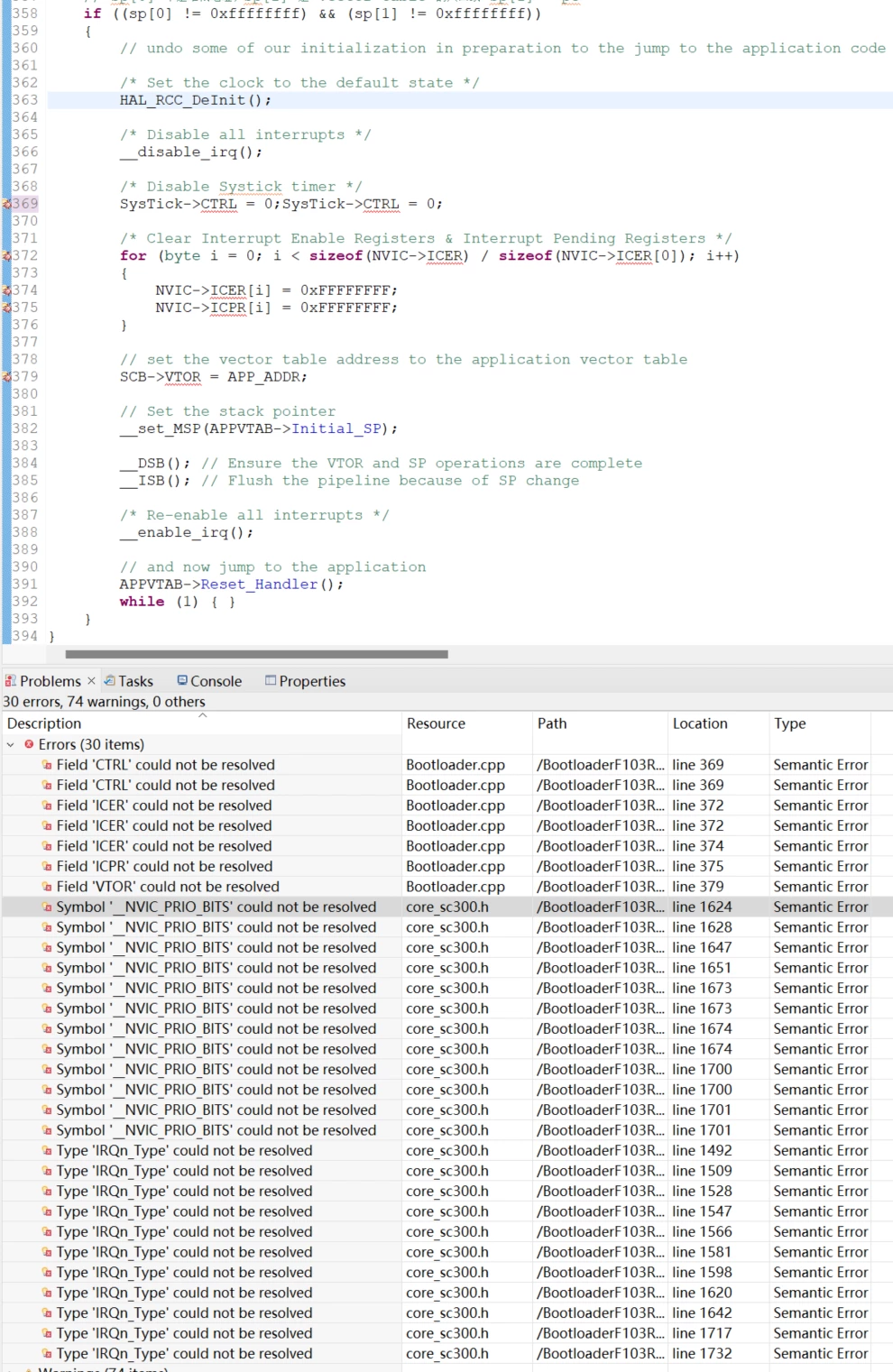

Symbol '_NVIC_PRIO_BITS' and Type 'IRQn_Type' could not be resolved in core_sc300.h
Recently, the CubeIDE reports these Semantic Errors when I build my project that has worked for months, I can't exactly remember what I had done when I first saw these errors, most likely because an SPI  Flash was added into the hardware system and configured SPI1 in CubeIDE. Because the newly added Nor Flash worked as expected, so the errors were ignored. Now I found that these errors make the jump from bootloader to App not work properly, it does not jump to my  App any more.
Please help!
