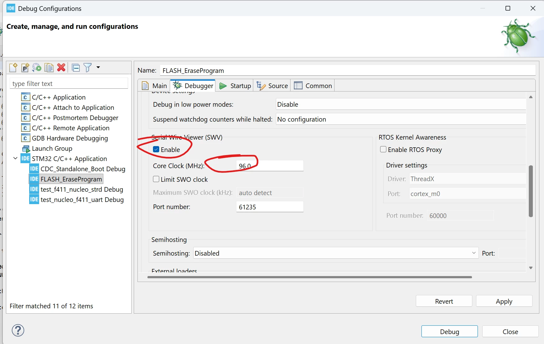

Is SWV enabled in the relevant debug configuration? What chip?
Paul M
Paul MAuthor
Aug 3, 2026 5:01 PM UTC
TDK,
Thanks, yes, I did enable that and also set the Clock Speed to match the HCLK in my MX Clock-Config
Paul++
