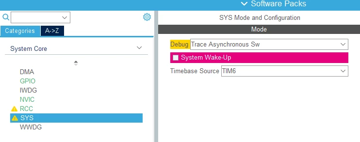

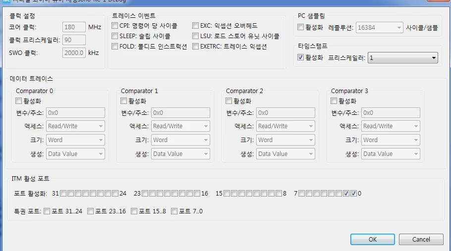

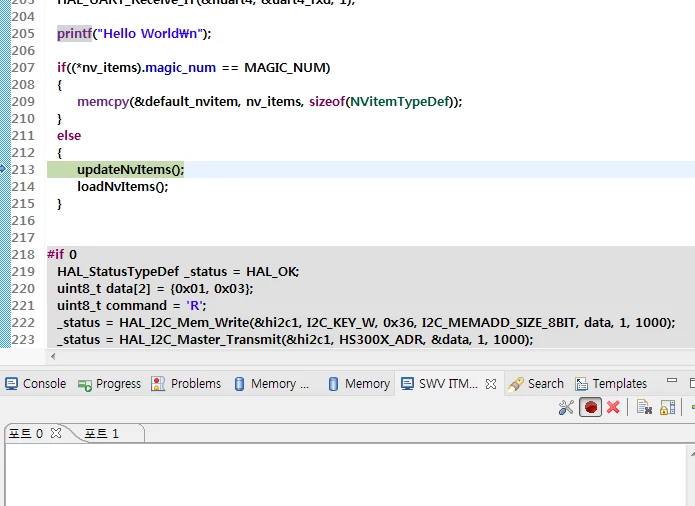

Hi, everyone
I use stm32f429ZI (180MHz)​
The setting contents were attached to the file
Any advice would be appreciated
Best regards,

Is PB3 / SWO pin wired to debugger or needs solder bridge made​?
Does ITM_SendChar() work?
Do you have plumbing working so STDIO uses SWV?​

The CubeMX configuration to enable Debug == Trace Asynchronous Sw, is actually not required at all with CubeIDE. Why? At debug launch, the CubeIDE will configure all needed registers on the device to allow SWV trace.
I also think that the first test should be to just use ITM_SendChar() directly to print a character on ITM-port 0. If this works, then you have to look at glueing it together in syscalls.c:_write() function to have printfs directed to ITM-port 0...
