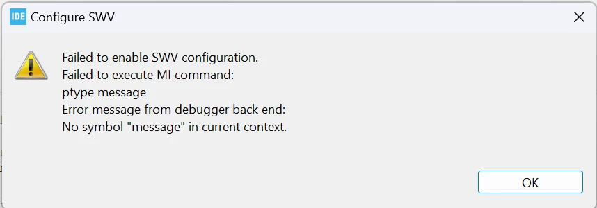

I want to use the SWD and ITM to print traces.
I followed the instructions of the STM32CubeIDE user manual but I got this error :

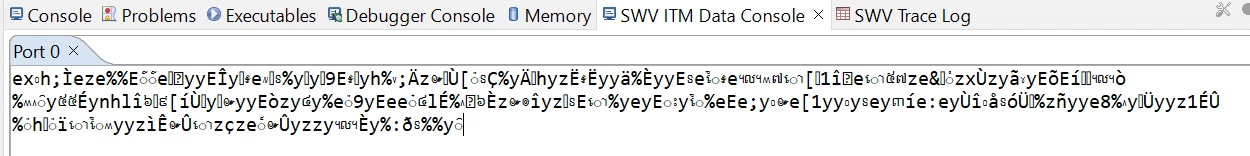

And I have this printed in the SWD Data Console :
I tried the solutions of the other topics related (even uninstalled stm32CubeIDE) but i've had the same issue.
My main is the following :
int main(void)
/* USER CODE BEGIN 1 */
int _write(int file, char *ptr, int len)
int DataIdx;
for (DataIdx = 0; DataIdx < len; DataIdx++)
//__io_putchar(*ptr++);
ITM_SendChar(*ptr++);
return len;
/* USER CODE END 1 */

char* message = "hello";
while (1)
printf("%s", message); // Utilisation de printf pour envoyer le message

I try to put the write function outside my main but I still have the same issue, I also try to put the debug in "Serial Wire" and then in "Asynchronous trace" in the .ioc but the error is still here...
Does someone have an idea ?
