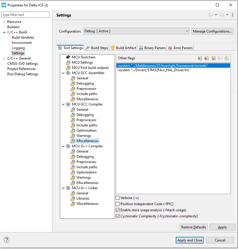

To suppress warnings in the library code used in the STM32 project, we changed the way that library headers are included and added subfolder-level project property tweaks to some (though not all) of the subfolders in the project that serve as logical groupings for some of the library source files.

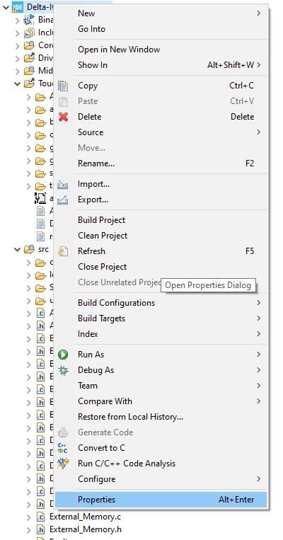

First, at the project properties level, right-click on the project and choose "Properties":

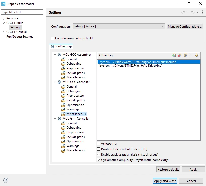

Then, in C/C++ Build -> Tool Settings -> MCU GCC Compiler -> Include Paths, remove ../Middlewares/ST/touchgfx/framework/include and ../Drivers/STM32F4xx_HAL_Driver/Inc from the list of Include paths. Once that's done, re-include them by defining "-isystem" flags for those paths in the "Miscellaneous" node's "Other flags" list:
The reason for this is that by including paths with "isystem" instead of just "i" implicitly tells the compiler to ignore all warnings generated by headers in those paths.
Once that's done, do the same thing under the "MCU G++ Compiler" node.

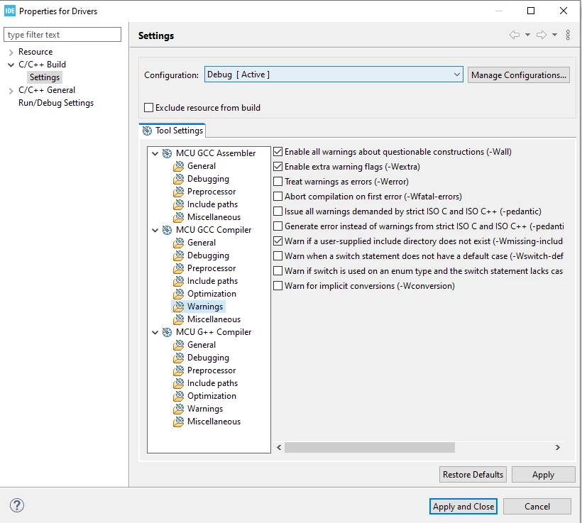

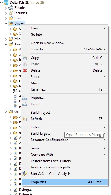

That takes care of warnings generated in the library header files, but additional steps are required to suppress warnings in the library source files. To do that, we'll take advantage of the fact that STM32CubeIDE supports subfolder-level properties independent of the parent project properties (and, for that matter, independent of the properties of any parent subfolders).
Most of the libraries in our project are grouped under the "Drivers" subfolder. Right-click on it and choose "Properties":

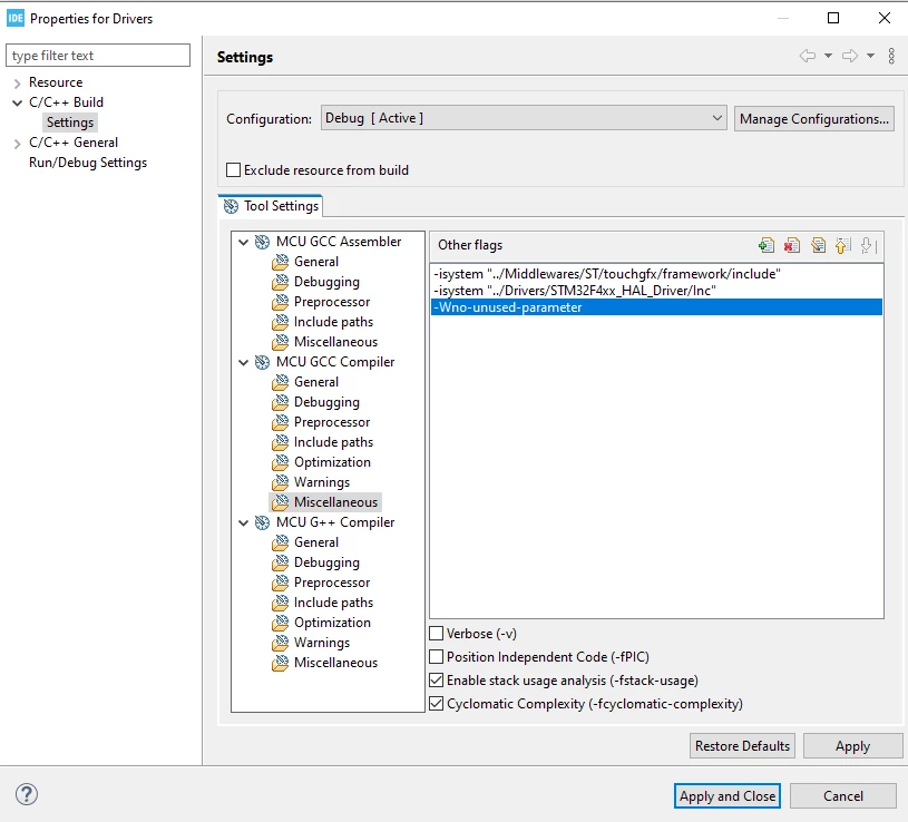

Under C/C++ Build->Settings->MCU GCC Compiler->Miscellaneous, add "-Wno-unused-parameters" to the list of "other flags" to suppress the "unused variables" warning for all source files under the "Drivers" subfolder:
Note that the two "-isystem" flags we added earlier were already automatically populated. However, also note that if we further change the parent project properties, those changes will no longer automatically propagate to the "Drivers" subfolder properties.
In other words, by defining special properties for the "Drivers" subfolder, we have in a sense unlinked it from changes to the project properties. Future changes (if any) to the project-level properties will need to be manually added to the "Drivers" subfolder.

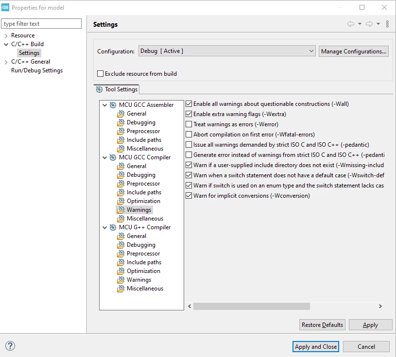

Continue by going to the "Warnings" node and unchecking the warning options so as to match this screenshot:
Repeat the above two steps (adding the -Wno-unused-parameter flag and unchecking some of the warnings) for the "MCU G++ Compiler" node.

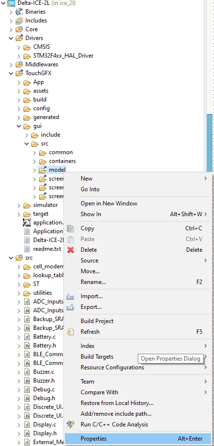

Once that’s done, we need to drill down into the TouchGFX subfolder and reenable warnings on a tiny bit of application code buried therein. Go to TouchGFX -> gui -> src, right-click on "model", and choose "Properties":
In those properties, undo the warning suppression meant for the library code by deleting the "-Wno-unused-variables" flags and re-checking the warnings that were disabled in the earlier "TouchGFX Properties" step:
Be sure to do the same for both the "MCU GCC Compiler" and "MCU G++ Compiler" nodes.
Now repeat all of that warning reenabling for the "screen_saver_screen", "screen_startup_screen", and "screen_status_screen" subfolders next to the "model" subfolder under TouchGX->gui->src
