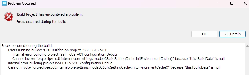

Suddenly occured error
There was nothing wrong when I worked on it until yesterday.
But when I went to work today and built it, an error like the picture appeared.
I can't guess the cause at all.
Reimporting the project or deleting the IDE and installing it anew does not resolve it.
How to solve it?

    This may help:
    * create new Eclipse workspace (empty folder)
    * import your project into that workspace
    1 reply
