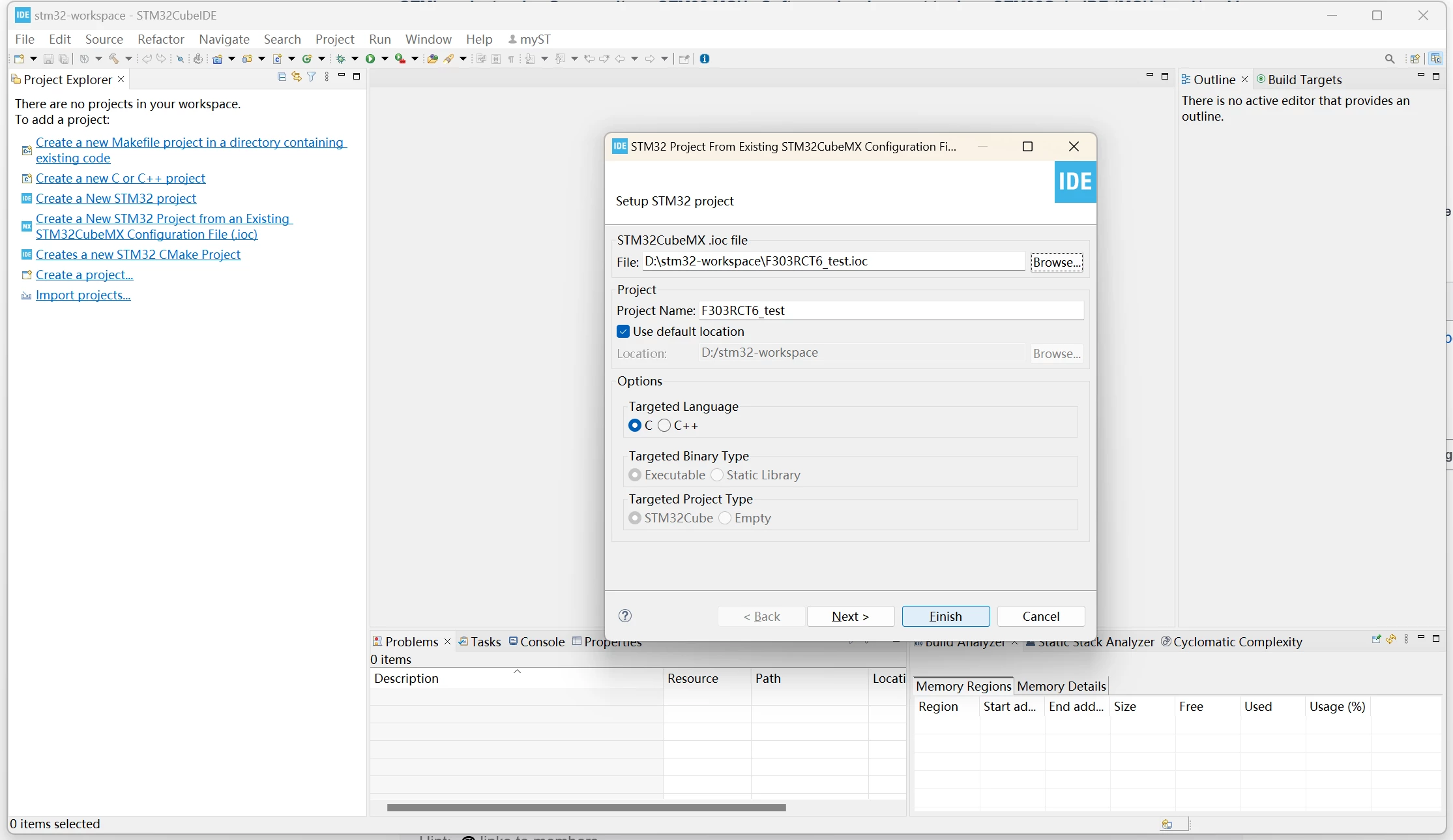

stuck on creating a new project from ioc file
I'm trying to create a new project from a exiting ioc file.
When I click the "finish" button, it shows a progress bar but disappear very fast, and it did nothing else. No new project created, no nothing. I don't know what went wrong. Is there an error log or something so that I can see what's happening?

Hello @soapshepard and welcome to the ST Community.
Could you please try to create your project using the Standalone version of the STM32CubeMX and generate it to the CubeIDE (by setting the IDE on the project manager tab to STM32CubeIDE). Else, could you please try to uninstall and reinstall the STM32CubeIDE (please ensure that you are using the last version). You can also try to restart your PC.

Feb 17, 2025 7:06 AM UTC
Restart pc solved the problem.
Should add a prompt in the installation process to tell people restart their machine after the installation.
