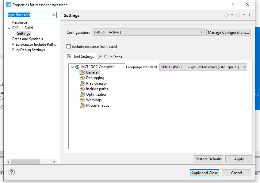

My understanding of strncpy_s is that it is a part of C11, and it is part of the string.h header file. I am unsure why my compiler does not consider strncpy_s as a valid preexisting operator.
My compiler is GNU11, so it should include C11 based on my understanding.
0693W00000YA3UPQA1.pngPlease let me know if more information is required.
Best answer by waclawek.jan
This function is defined in C11 Annex K, which is optional. Quoting from C11 (footnote 380 in Annex K):
Implementations that do not define _ _STDC_LIB_EXT1_ _ are not required to conform to these
specifications.
newlib does not appear to implement Annex K functions.
specifications.

Thank you. Is there a setting I could configure, or external file I could place within my project to implement Annex K?
