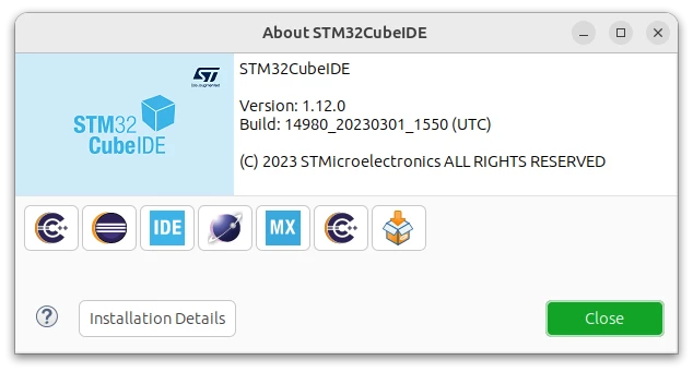

Hello!
Version 1.12.0, Ubuntu.
I wasn't aware of 1.12.1. I'm going to try, just in case.
