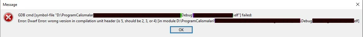

Hi all,
I could follow the values of the variables in the programs I wrote with STMCubeide with StmStudio. But with the latest 1.13.0 update, StmStudio has started giving an error. The error is like this; "Dwarf error: wrong version number in complation unit header (is 5, should be 2,3 or 4)" how can I solve this error?

    Try to install an older toolchain (same that you've used before update)

    @MMARI.1 Please locate in CubeIDE project settings the ARM toolchain version. Do this in the older CubeIDE version, before update. After update, go to the Toolchain manage dialog, install the previous toolchain, then select it in your project settings. Always keep notes about the toolchain version and all other tool versions.

    >I am really scared of changing the tool chain current setting and it may disturb my current work flow
    Don't worry. First, you will be using the same (older) toolchain that you already know.
    Second, the choice of toolchain can be made per project or per workspace. Just try in on a new workspace aside from your main project.
