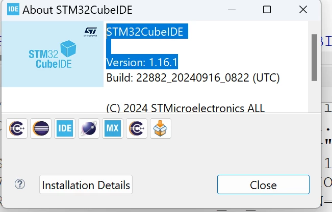

STMCubeIDE v1.16.1 UI is Trimming Double Quotes when Adding Symbols to Project
 Issue occurs in this build:

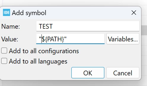

  • Select the Symbols Tab
  • Add a new Symbol and in the value field, reference an environment variable inside quotes e.g. "${PATH}"
  • Click save and the trailing double quote is removed

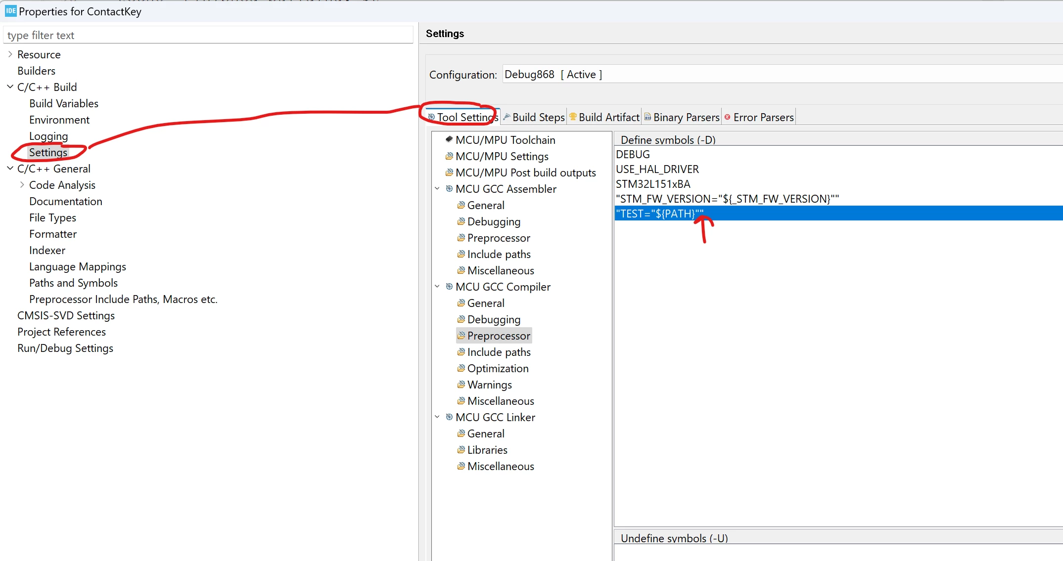

The workaround is to edit the symbols elsewhere see below noting where I added the extra quote:
