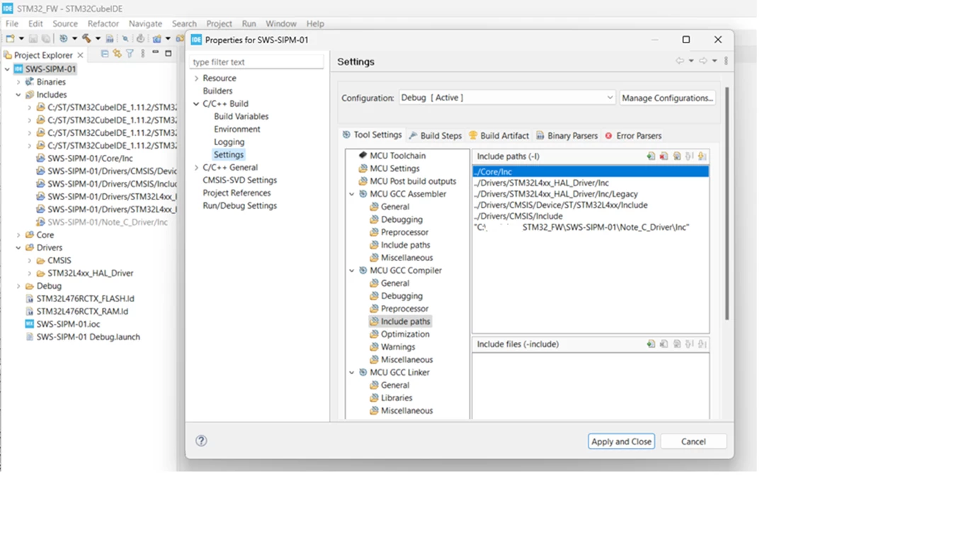

I have downloaded source / header files from github and placed them in the /Driver folder on my existing project. I included them in the project properties. as you can see from pic it shows up under Project Explorer Includes section but it is greyed out. I also notice underneath the Project Explorer Drivers the folder Note_C_Drivers does not show up.....
Can someone show me where I need to go within the Project Properties to get this code to show up???
If I do this with TI and in Code Composer Studio this way the folder shows up and appears black not greyed out.....
Thank you

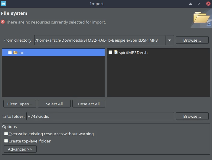

no....try: import !
so : click on your project, gets selected (blue) . here right mouse click -> import -> file system ->
next ->
0693W00000YAONKQA5.pngselect directory - files you want to import (.h in inc here in my download, then same procedure again for .c source files)
-> finish.
now they are in your project and the IDE knows about them. just include in your main ...

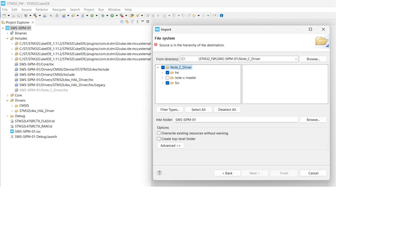

I'm close here but Finish is greyed out???
AScha.3
February 9, 2023
only (!) in right window are the files to select...choose directory with matching files and select them; left window is the directory, you choose.
+ see the warning : source is in your target directory. thats impossible to "move" or copy.
