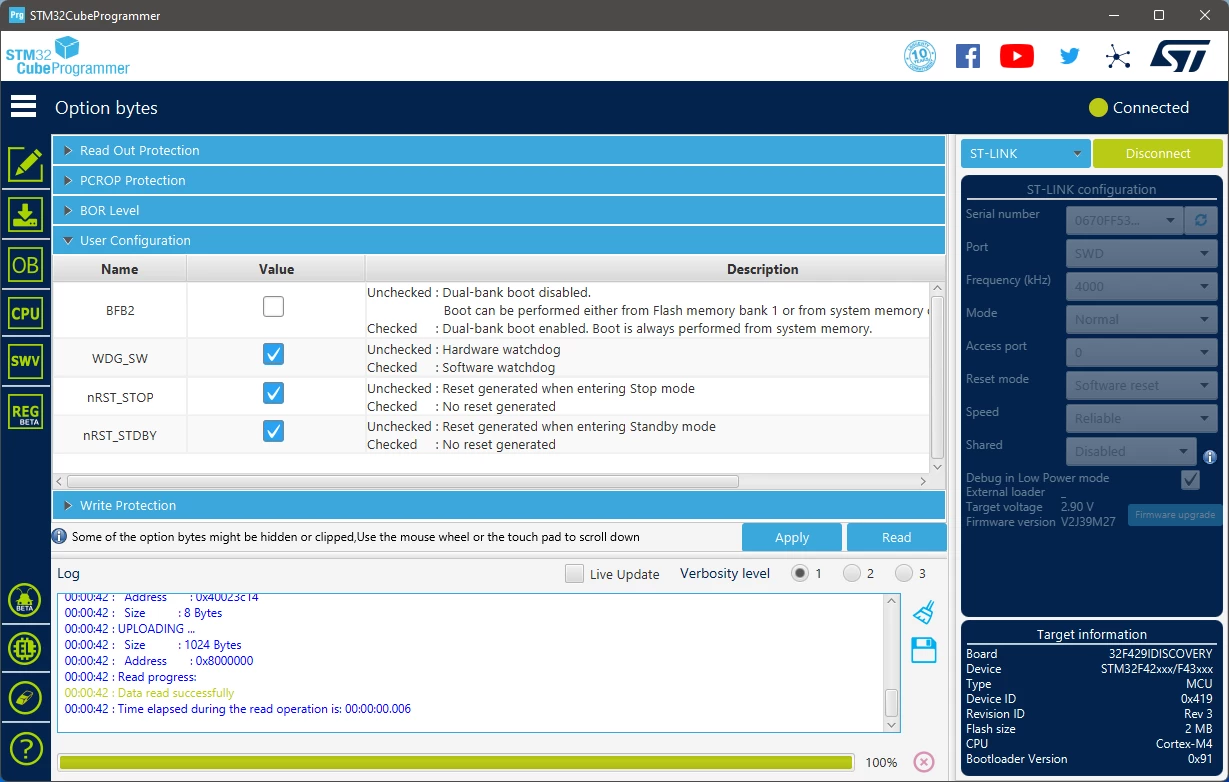

STMCubeIDE gives the message "Break at address "0x1fff5162" with no debug information available, or outside of program code."
Hello. I work in CubeIDE 1.9.0 with the stm32f429i-disco device. The problem arises about firmware and debugging. I made a simple example to check. During debugging, strange behavior was noticed when executing HAL_Delay (line 95). When executing Step Over on this line, Debug Current Instruction Pointer remains on the same line. If you put a breakpoint on this line and Resume, the LEDs are reset to the initial (off) after each iteration, although they should change their state every 250 ms. Previously, I worked with bootloader on this board. I also noticed that the user USB LED lights up when power is applied in the absence of firmware in the memory of the microcontroller. Keil faced the same problems that were described above. Tell me, please, can this be the result of mechanical damage to the board or is it something else and how to fix it?

Check BOOT0 pin, and the option bits.
3 replies
March 26, 2022
Unlikely to be an issue caused by mechanical damage.
Sounds like the systick handler might be pointing somewhere in system memory space.
Is the IWDG enabled in option bytes?
When you pause, does the VECTACTIVE field indicate it's within an interrupt or within the main loop?

The problem was the optional bits. Apparently, when working with the bootloader, I ticked BFB2. Unchecking the box solved the problem. Thanks to everyone who responded!0693W00000LvrKCQAZ.png
