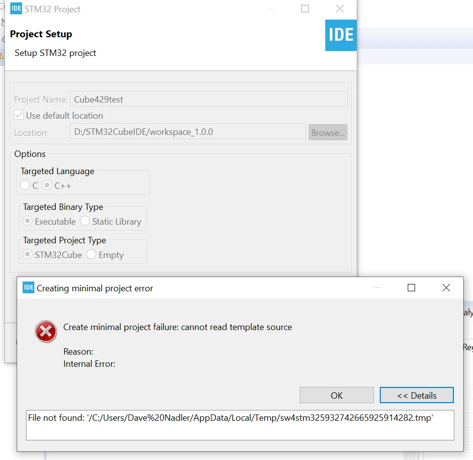

Just downloaded and installed STMcubeIDE 1.0.0 but it doesn't seem to work at all.
Tried to create a new project:
  • selected board Nucleo-F429ZI
  • tried to create a project
Fails as follows:
Any idea what's going on here?
Has anybody actually gotten this stuff to work?
Thanks,
Best Regards, Dave

%20 is a space, if I'm not mistaken? Is the user name Dave Nadler?
There's a ticket regarding the installation not working if installed into Program Files but I guess what is happening here is that project creation won't work with a space in the user name either and is generating a different kind of error.

Yes, user name has a space - as do many if not most Windows machines...
The installation default should be under "Program Files", not a c:\ST\... directory! Really!
I did a 2nd install using the non-standard C:\ST path but got the same error.
Are you able to verify that the blank in user name is the problem?
What's the plan to fix this (and the default installation location)?
