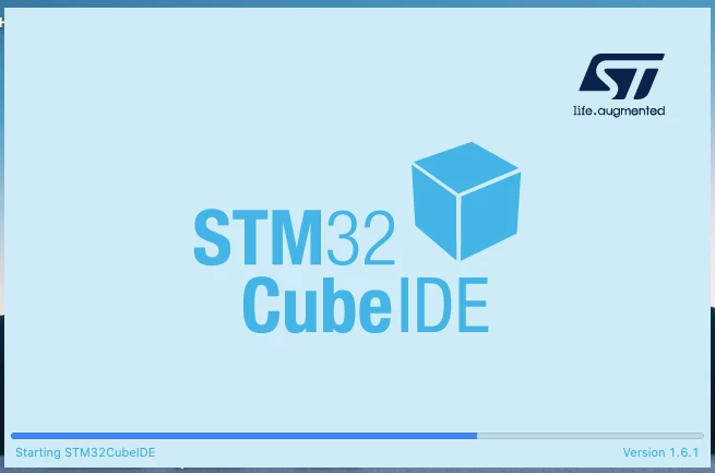

STMCubeIDE 1.6.1 not opening on MacOS 10.15.7
it just gets stuck on this screen forever.

What happens if new session asking for brand new workspace location ?​

thank you @Cartu38 OpenDev​, making a new workspace helped.... the IDE opens now. I guess something is corrupt in the original workspace.

For my info looking for corruption root source ... do you exit a previous session abnormaly (crash or kill usage ?). If yes was .ioc editor open at that time ?

yes, I was starting a new project and the IDE just got hung up in the middle of downloading some files from ST I think.... either way, it got stuck so I had to force quite.

Thanks MKuciara for you logs files, their analysis allowed to identify the root cause.
Hopefully it could be fixed for next release.
Waiting for this the workaround described by @Cartu38 OpenDev​  stays fully valid.
