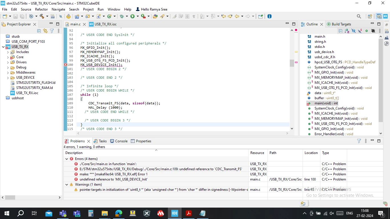

i am working with STM32U575RIT6,
i want to read and write data through USB_OTG_FS (without threadx).
i have externally added the middleware and usb device files (not generated files) to my project.

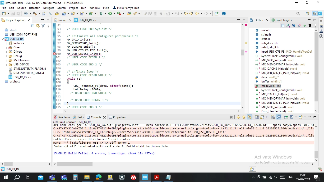

i am facing a linker error,
all the file paths and the functions declarations are all fine, no errors observed.
whenever i am trying to write code in main.c, i am facing the linker error.
i have attached the images of it, check them and let me know what i need to change.
this is the error in consolethis is the error in console

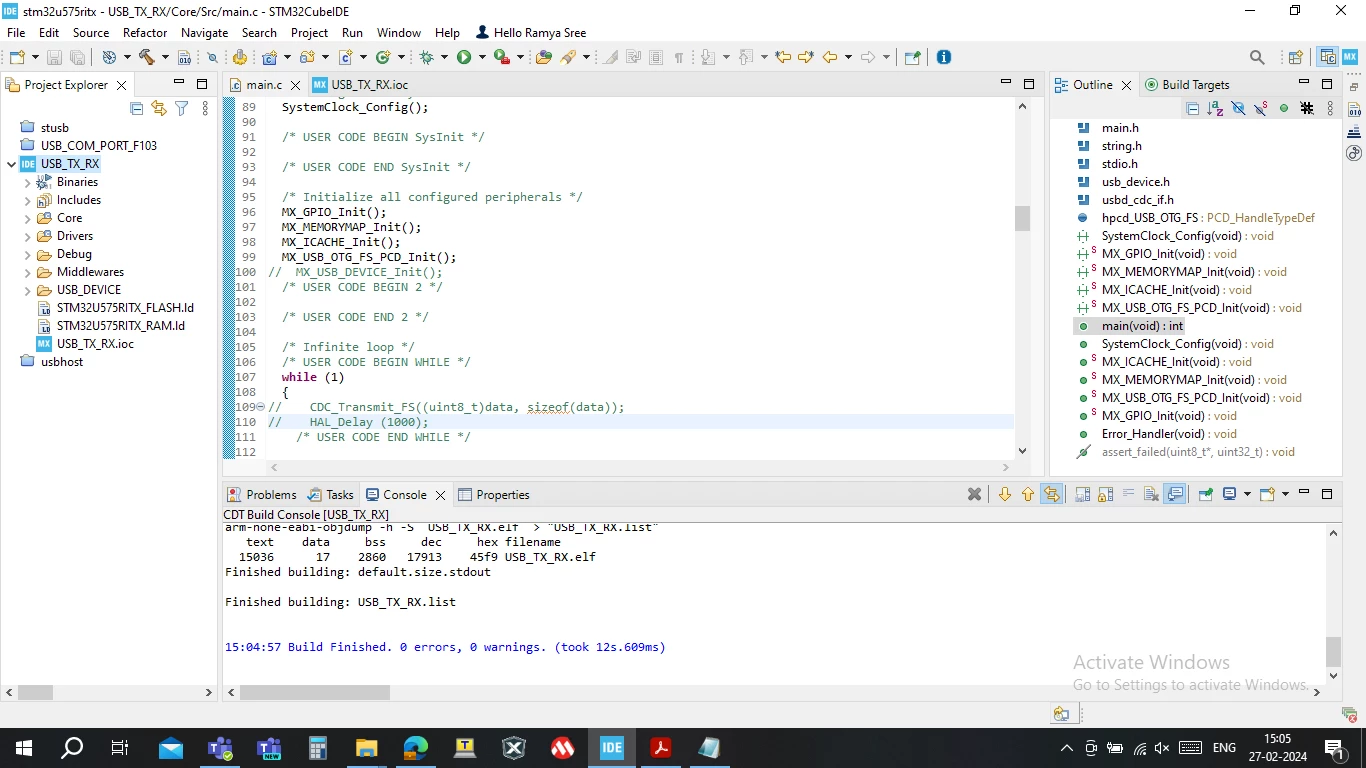

when code is added in main, i am getting errorswhen code is added in main, i am getting errors
i commented the functions and tested, no errors observed.i commented the functions and tested, no errors observed.

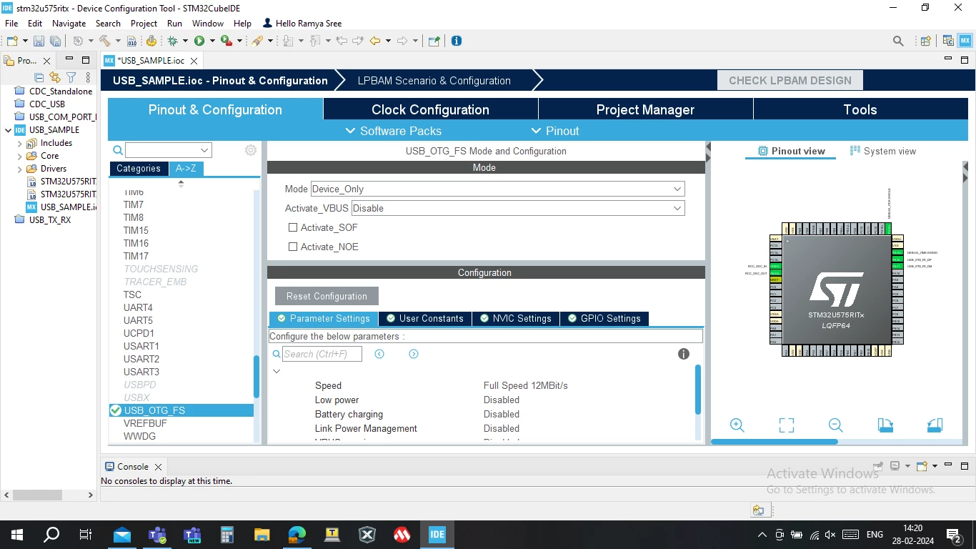

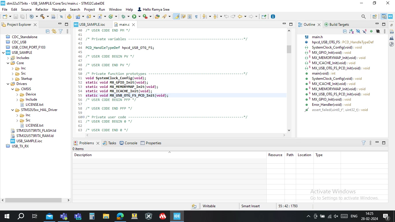

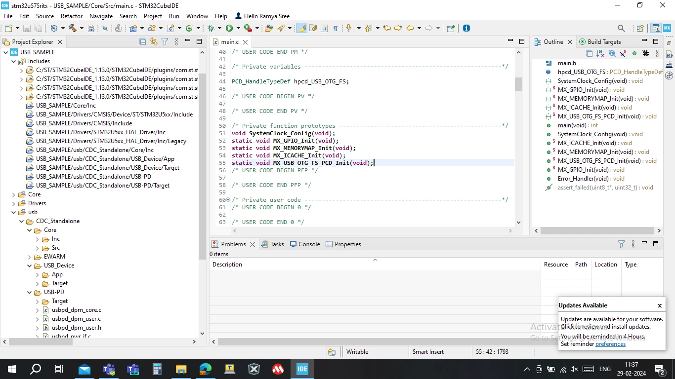

i have gone through the link and added the CDC standalone file system, but the problem is that, during the code generation, the middleware and usb files are not getting generated. check the attached images.
generated source filesgenerated source files
usb otg fs configurationusb otg fs configuration
the usb and middleware files are not generated,
whenever i try to add them externally i am getting the linker error.
so how can i solve this?
am i doing anything wrong in the configuration?
y are the files not generated?

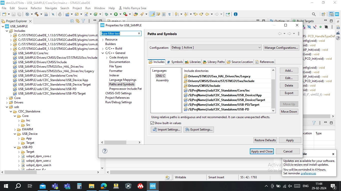

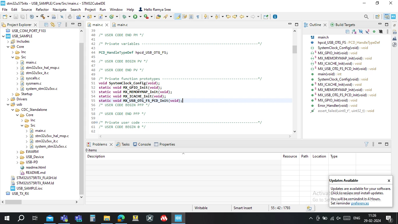

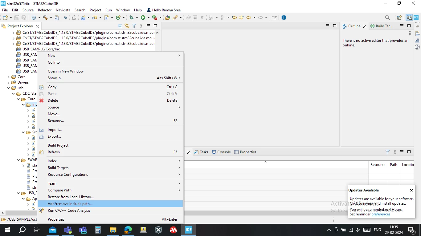

this is my first time working with external libraries, so can you please share some article which helps me to understand how to add the file paths properly in stmcubeide.
till now i am adding the path by a rightclick on the include folder and click the option "add/remove path".
this is how i have added the files earlier.
i haven't used the properties path as @Mohamed_AYED mentioned.
i have added the images for better understanding, please check and let me know your comments.
all of your responses are much appreciated, as i am new to USB and STM MCU.
i am looking forward to learn more on STM and USB with all of your guidance.
 this is how i have confirmed the paths are added.
this is how i am adding the paththis is how i am adding the path
i have 2 main.c files if i add the whole CDC standalone file systemi have 2 main.c files if i add the whole CDC standalone file system
the paths are present in the properties window too.the paths are present in the properties window too.
