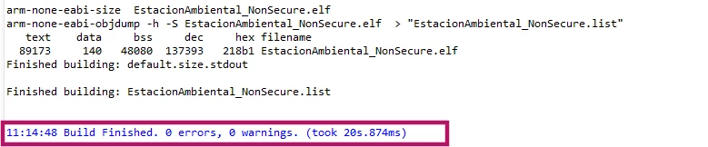

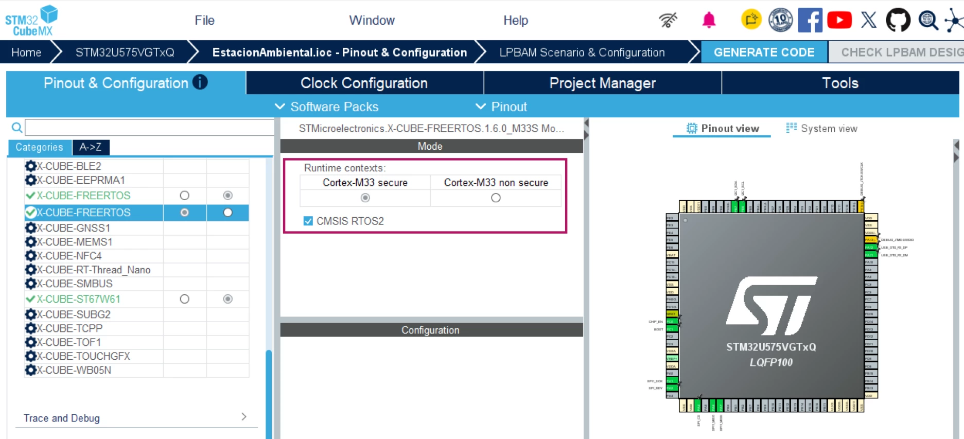

Sep 16, 2026 10:18 AM UTC
Hello ​@bitsandscience
I reproduced the behavior described, you should enable the FreeRtos package in the secure context.
Then generate the code.
You should also build the secure project before the non-secure project and the build will be finished without errors.
I will be waiting for your feedback.
Thanks.
Mahmoud

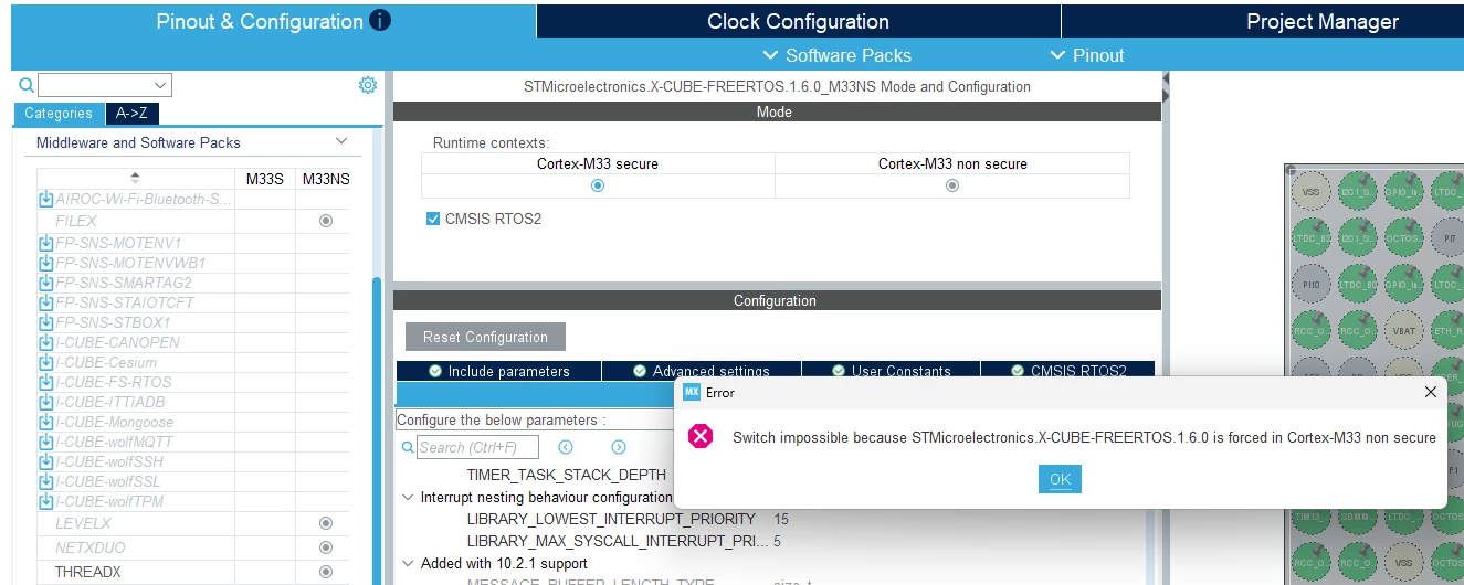

RConf.1
Oct 16, 2026 11:02 AM UTC
I write here because I have the same problem presented in this topic, but using:
  • STM32H5F5J-DK
  • CUBE MX 6.18.1 + VS Code with STM32CUBE extension + CMake
  • STM32Cube FW H5 V1.7.0
  • X-CUBE-FREERTOS 1.6.0 / FreeRTOS 11.2
  • TrustZone enabled
  • FreeRTOS running in NonSecure (TZ_Non_Secure)
  • FreeRTOS Secure support enabled (TZ_Secure)
In addition to what already discussed, my issue is that I cannot follow the workaround proposed by ​@Mahmoud Ben Romdhane, because I am not allowed to enable the FreeRtos package in the secure context (as you can see from the attached picture).
Please let me know if the only solution is to copy those four .c files into the Secure project and added the include paths as suggested by ​@bitsandscience.
Thank you for your help.
Best regards,
Riccardo
Oct 19, 2026 10:31 AM UTC
Hello ​@RConf.1
Further to your comment, this is the expected STM32CubeMX behavior.
I have enabled the X-Cube-FreeRtos package in both Cortex-M33 Secure and Non-Secure and I have generated the code with CMake Toolchain. The project build compiled without errors. Knowing that you should build first the secure project.
Thanks.
Mahmoud
RConf.1
Oct 20, 2026 7:31 AM UTC
Hello ​@Mahmoud Ben Romdhane,
thanks for your answer. Following your procedure, the project build compiled without errors.
Thanks for your help.
Best regards,
