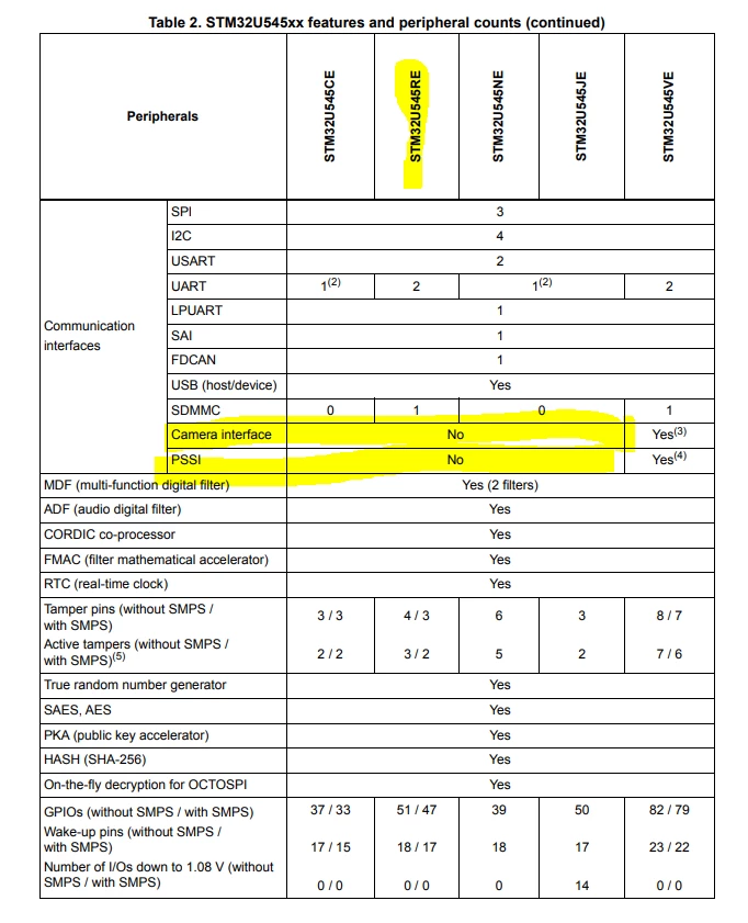

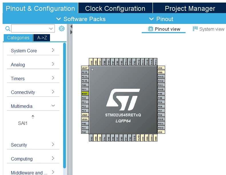

As in the subject, DCMI and PSSI are missing from STM32U545RETXQ configuration. According to documentation, this unit should support those interfaces. Is that correct? Regards
STTwo-32
STTwo-32Best answer
Hello @mk11 and welcome to the ST Community :smiling_face_with_smiling_eyes:.

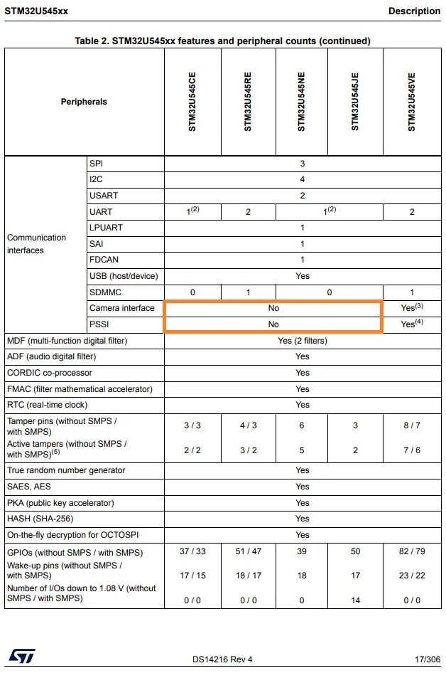

As you can see on the DS14216, DCMI and PSSI are not supported on the STM32U545RE:
Best Regards.
